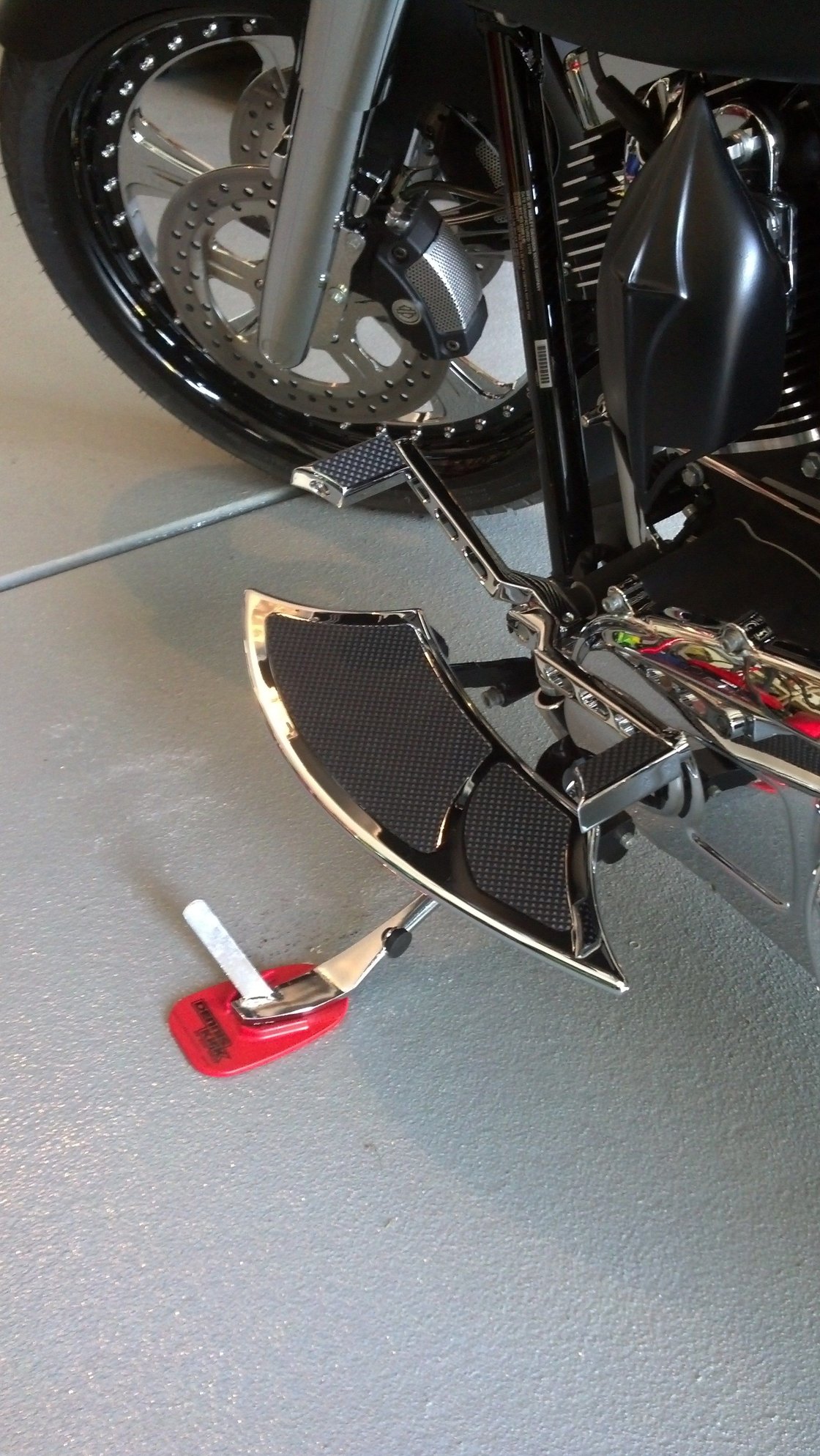

I have the Baddad 992's, and I do not notice any diff between them or stock.
