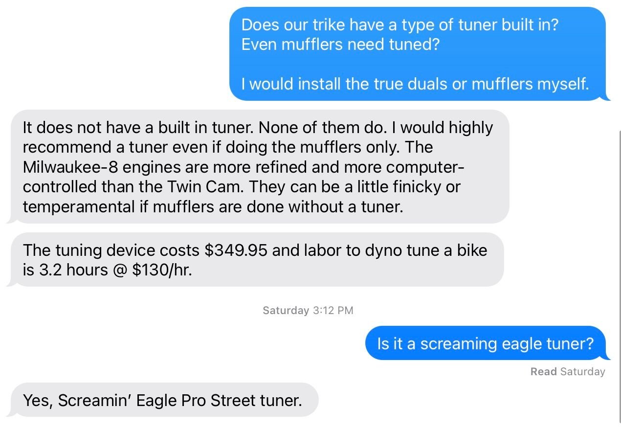

here’s a screen grab of a text from a dealer rep
He says it’s the aftermarket tuner that voids the warranty, not the exhaust.

I am getting mixed messages here.
I had a screaming eagle tuner on the Ultra and it was sufficient for my needs. I don’t plan on drag racing or building the motor on the trike so any tuner that does more than the SE would be unnecessary.
I’d like to think the fella I’m texting with knows what he’s talking about. If he’s given others the same advice about tuners, exhaust and warranty, and then they lost their warranty, I’d think the dealership would have fired him or at least instructed him not to give that advice anymore because of all the p’d off customers.

Just adding mufflers is not going to require a tuner. Anyone that tries to tell you that is full of crap.
I wouldn't waste my money on a Harley tuner, unless it's absolutely necessary.

Im sorry. But that “Chrome Consultant”. Lol. Is full of ****. You absolutely do not need a tune with mufflers. And altering the emissions will void the powertrain warranty. There’s a few threads here where it has happened. The digital tech will tattle tail in the tuner yes. Immediately it checks that.
