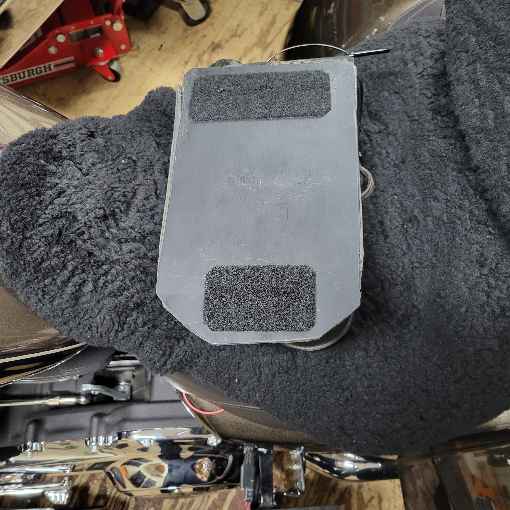

I had an old set from my '05 Ultra that I added to my trike. Couldn't bring myself to drill holes and worried about sticking velcro to the paint so I added 6" 3M paint protector film 1st then tried Velcro top and bottom of the bags. (glued a piece of plastic to the back of the the bags to give a nice flat surface) It worked but not well if pulled straight off. So I tried the velcro duel lock type. It was actually worse. But then I tried using it with the loop (felt side) of regular velcro and it works best. So far anyway. You really have to tear it off. FYi, that section of the inner fender has a slight curve to it so you can't just put a strip down the length of the bag. The thickness of the velcro holds it just enough off the fender. I would love to get the new style bags but a bit too pricy. These will work for as little I have to use them.

I felt the synthetic leather wouldn't hold the glue well. Added rivets top and bottom to make sure plastic never separates from the bag. I have these polished SS inserts as a back up plan if the Velcro doesn't work out. I would use polished SS button head screws so it wont look too ugly when the bags are off.

I'm on the hunt for some plastic to use as backing. Thinking of the side of a office trash can [ I have a half dozen extra] glued to the leather with some real sticky double sided tape then riveted to the bags.
