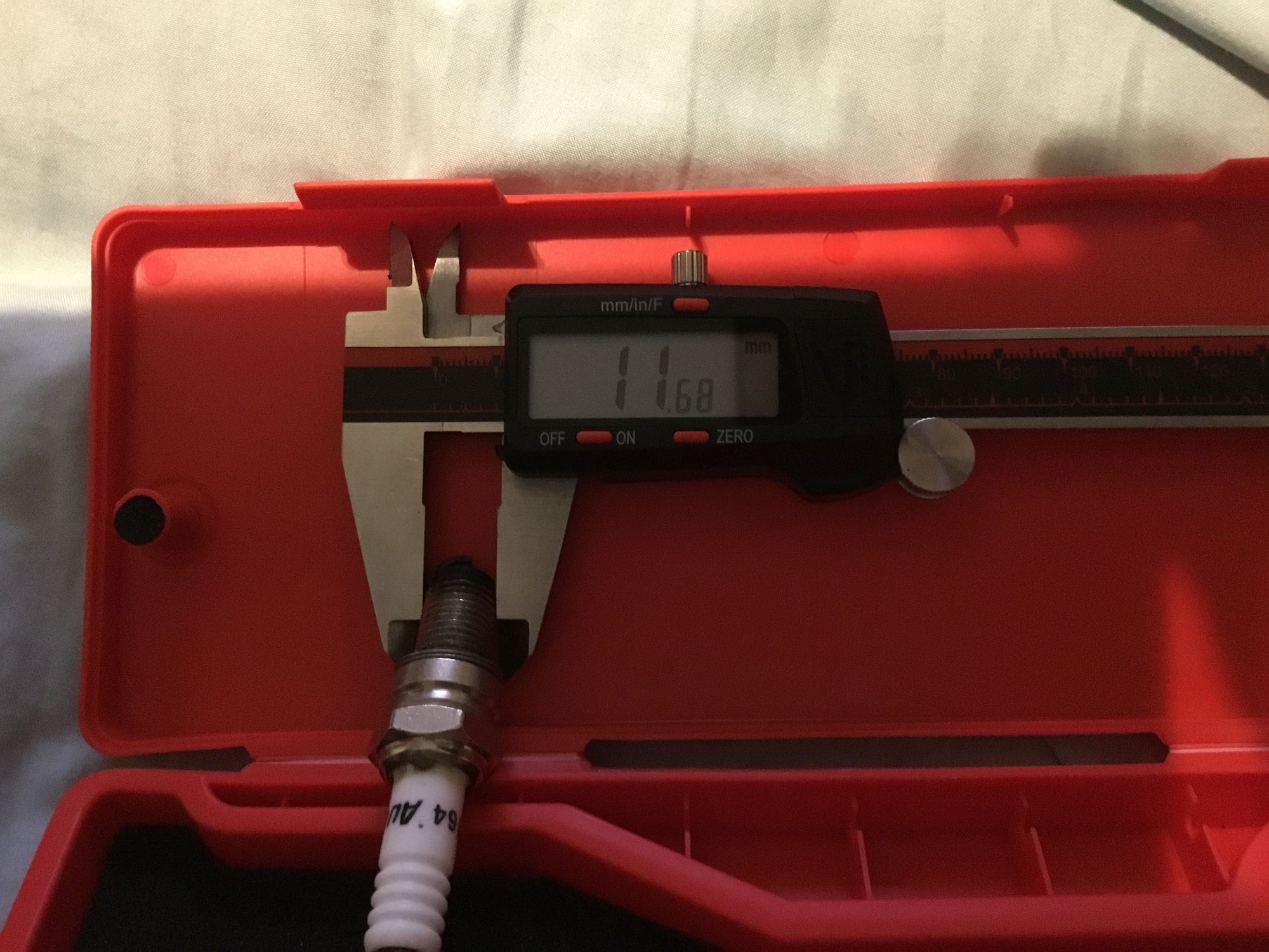

Yeah, I’m starting a thread on a dumb question that shouldn’t be a question. I have a 2015 HD FLRT 103HO With 8000 miles. I bought some Iridium Plugs while I was out of town from a Cycle shop that deals with parts for HD only. He looked up my trike and engine size and sold me the plugs. I’m now at home and go to install them. Installed my 409 Taylor wires from DK Customs first, pull old plugs (disappointed that someone used screw-nippled Autolites) with an 11/16 socket. Ok I say but don’t care because I’m junking them…right? Wrong, I had to reuse them because the thread size is much smaller (7/16) than the ones I bought (1/2) but when I search online I find plugs that have a thread size of 11/16 that say they fit my Trike. I know the easiest solution is to take my plug and match it in person at the store. I’m going to do that. My question is… Are all of the parts Stores wrong or is it possible my motor had work done that would change the size spark plug used? Everything on the bike was stock all the way down to the shifter pegs.

Champion - RA8HC
H-D Standard - 6R12
OEM - 32362-04A
Also, the thread isn't 7/16, it's 12mm x 1.25mm.

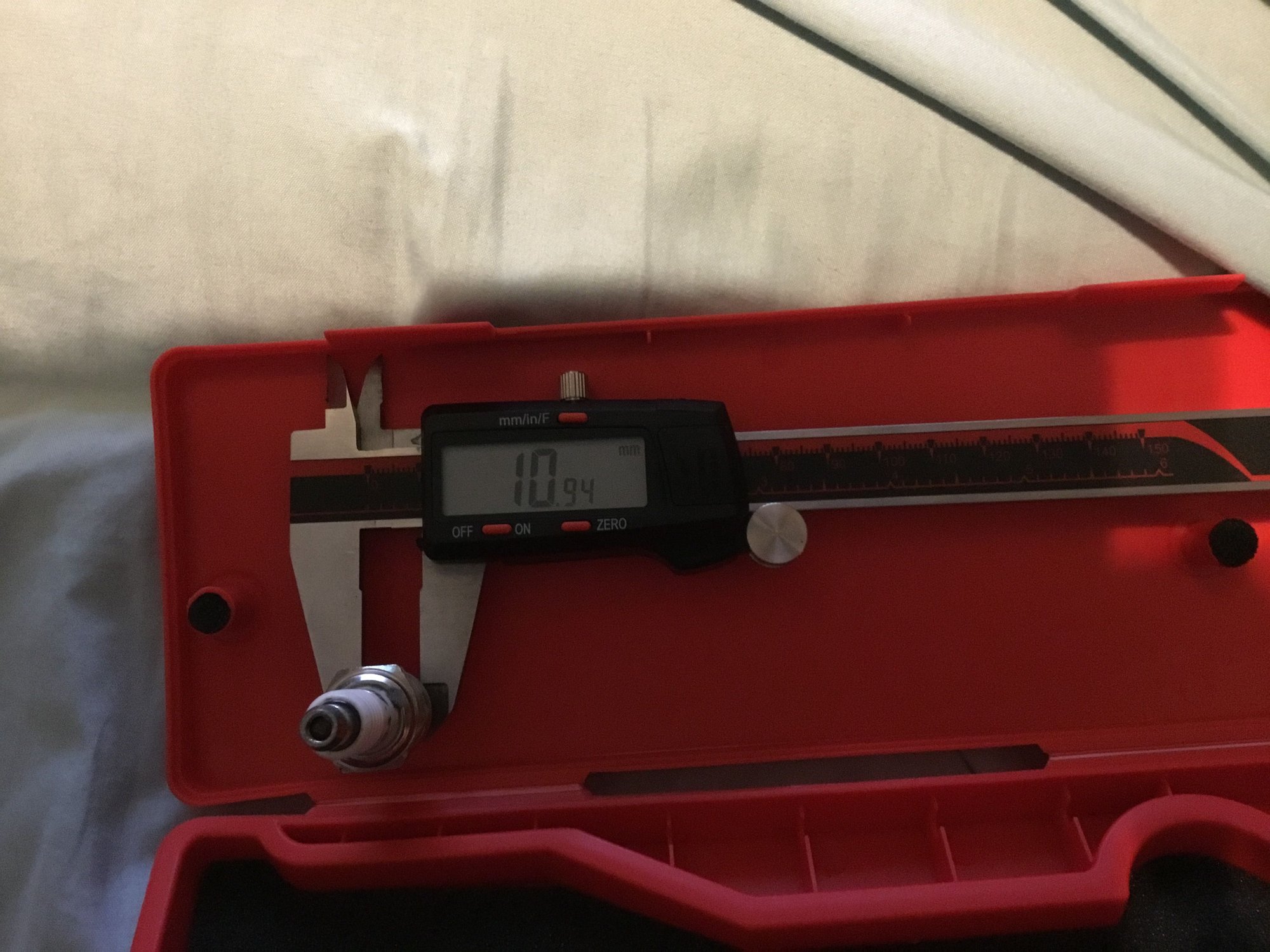

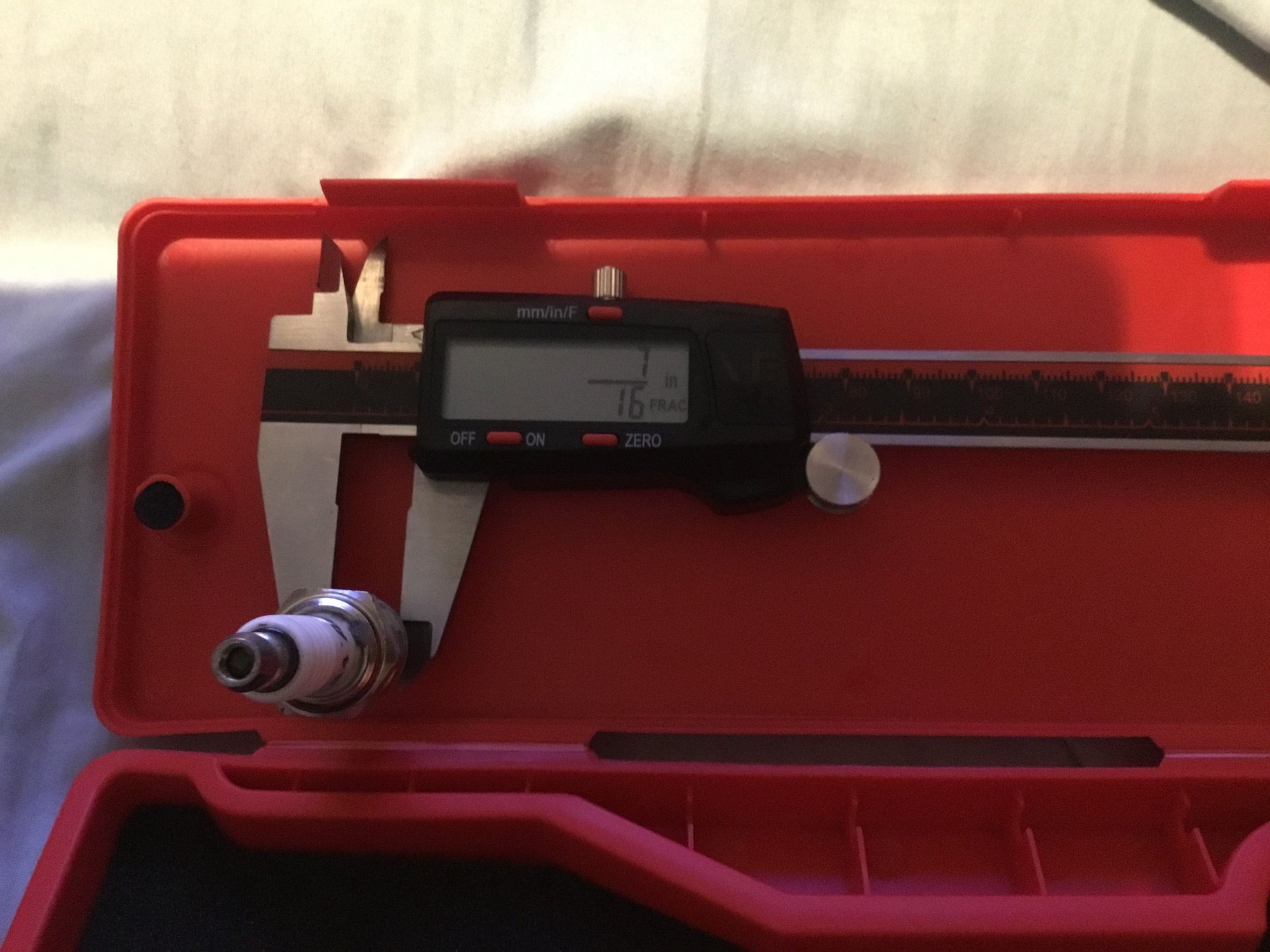

The Autolite 4164’s That came with this bike.
outside of threads
