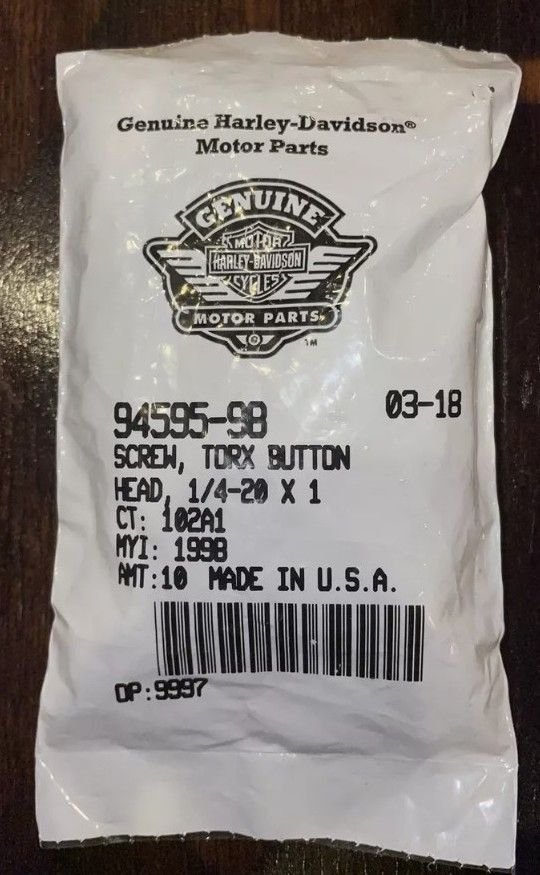

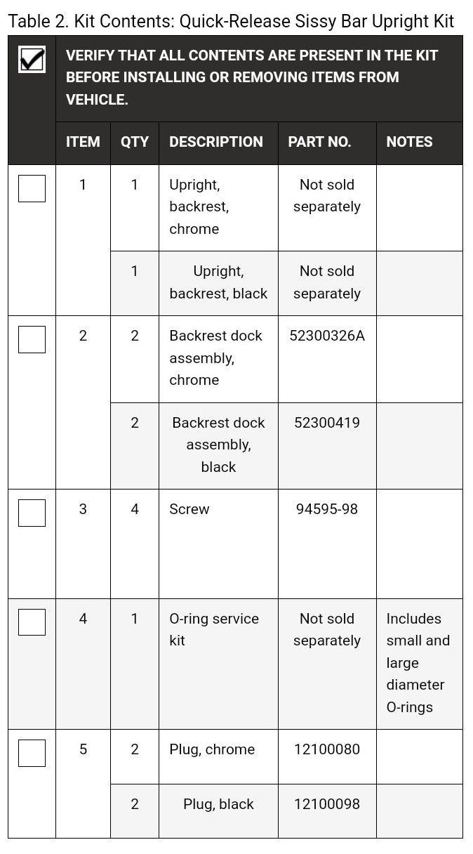

I need the bolt size for the qd mounts for the Freewheeler passenger backrest mount. I do not want to waste time waiting for replacements and just go to the hardware store.
Can anyone help?

ETA: If you have the instruction sheet that came with it….
Check the parts inventory portion for the part number for the screws.
Then internet search for the part number.
Great idea to hang on the wall for just such occasions……

Thanks everyone, I got it.
