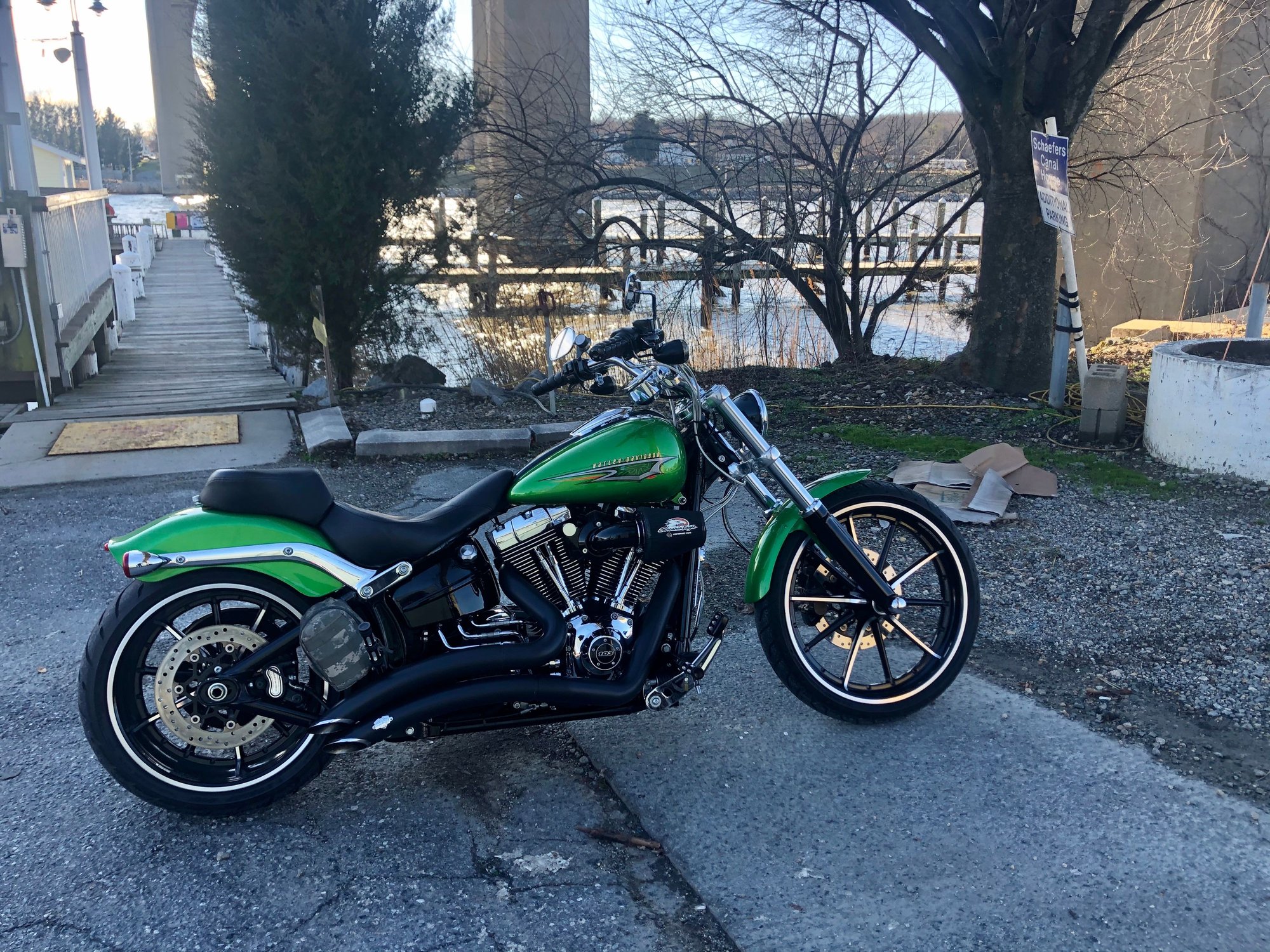

Hi,
I have a 2015 Breakout FXSB 103 . I bought it used in 2016 with 2600 miles on it (it now has 14,000 miles on it)
I bought it with these parts already installed on the bike when I bought it ;
the screaming eagle k&n snorkel type cone air filter intake , and Vance & Hines street sweeper pipes.
The original owner, gave me the screaming eagle super tuner pro programmer with it.
I have a tiny oil leak coming from the back cylinder under the valve cover, so I was going to replace the valve cover / and rocker cover gaskets this winter and was thinking, of doing cams While it’s Half way there.
I don’t race the bike, or redline it, I usually shift between 2500-3500 rpm and my wife I take long rides on the weekends, mostly back roads, but we do highway as well (100-175 miles round trip each time). With that being said, what cams do you guys recommend I get something with more Low end power, would be what I would think?
What are your thoughts on the SE 204 cams?
my next question is, I read to obviously do cam bearings as well. What else do you recommend I replace while in there? I run full synthetic and don’t let it go over 3,000 miles on a oil change (yes I know that’s a waste, but I do it anyway.)
I plan on keeping this bike a very long time and hope to see well over 100k on the odometer one day.

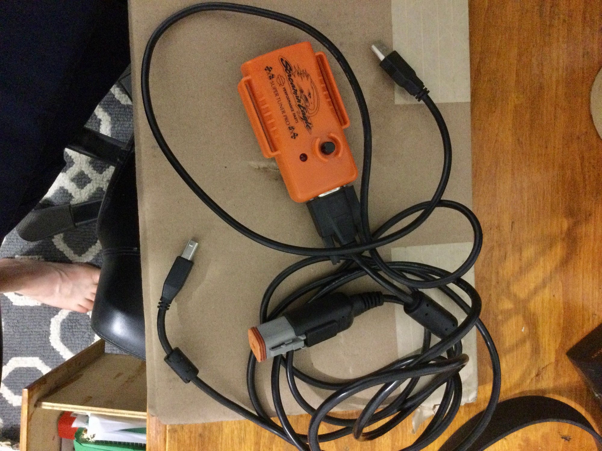

I also do all my Own work, it my first Harley and have never opened up this engine or another Harley engine, but I have a manual and want to do all the work myself. which leaves me to my next question... how does the tuner work? Hook it to a lap top? Do I need to have a shop tune it, or can I down load a tune and install it myself? If it does need a tune from a shop, is it safe to ride it to the shop with out the new tune?
I sorry for all the questions, just looking for some help, guidance and advice. I appreciate all your answers and help.

Good advice. The tuner does allow access to "maps", other ECU configurations; however, finding one that matches cam, intake and exhaust might be difficult. A dyno tune is worth the cost to optimize the performance of the upgrade.

I completely agree with both of the posts above. I've done 2 cam swaps this year with my TC103 bikes. I've found that a dyno tune by a reputable tuner lends to a better running machine vs. any custom map will, or even a custom map that's been autotuned on.
I put the Andrews 48h cams in my Softail and it hit the mark for what I was looking for. Power comes on sooner vs. the stock cams and it shines primarily in the mid-range. Works well in a 2-up setup. It's a great set to consider for broad power. If you want more low-end focus the TTS100 as mentioned would be a consideration. S&S 583, SE255 are some others that come to mind. I think something with an IVC of <30 would likely be most appropriate for what you're looking for. The SE204s are a nice set, but I don't think they will deliver what you're after.
I see you are in Oaks. I'm right over in Skippack. If you want to meet up sometime and ride my Softail with the 48h cams and same V&H exhaust that you have, you are welcome to. I can also provide some dyno tuner recommendations if you'd like. The reputable tuners around here suggest the TTS unit or Powervision FWIW.
