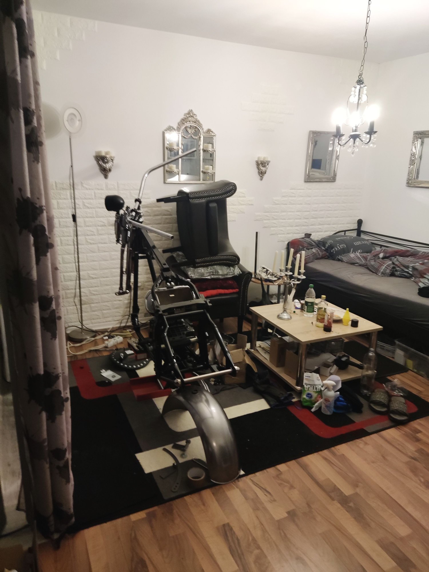

hello from germany.i live in germany berlin and have now started the 3rd conversion. I have the tc88 from 2006. I bought the s+s 89cc cylinder heads and the 100cc Sidewinder 4 s+s cylinders and the 585 camshaft. I have converted to carburetor s + s Super G from 93kubikzol. here in Germany no one builds on carburetors anymore. what do you think my setup can work? in addition there is the ignition module from Altmann. Best regards from Berlin to USA the inventor of the Harley Davidson.

I will install the motor in the next few days. I have installed new bearings and painted the motor housing.
My Home
No more balancer
