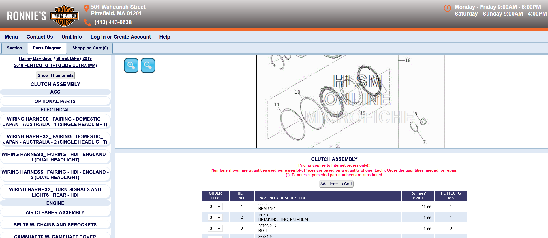

I just tried to do a sreenshot at Ronnies on PC, and it asked to cut out. In the past when trying to copy and paste text a message would pop up. Now you can do that too. Not sure the site or new version of windows, or browser. But either way, I said to go look at it yourself. So I really don't care.

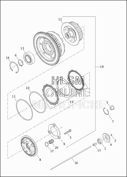

You must be doing something incorrectly. I am on a computer and just saved the image using the right click feature and took a screen shot and saved it.
Your attention is invited below to the posted images.
Additionally, you can go to the H-D parts lookup and it is easier to look for parts and download images with the right click feature:
https://www.harley-davidson.com/us/e...s?aribrand=HDM
Your welcome, have a nice day

Yes it will now allow me, even lets me to draw a border around it. In the past a pop would come up on the screen. I used to try and copy and paste parts numbers when building spreading sheets for big jobs.
