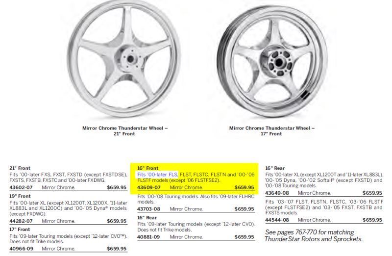

Here's another example ...
From the 2015 Harley Parts and Accessories Catalog
Notice your 2012 FLS is in the listing as 2000-later ... 2000-06 uses 3/4 x 21mm bearings ... 2007-later uses 25mm x 15mm
How do you think HD can offer the same wheel to use the two different widths of bearings? ...
Now Read or Re-read Post#1 in the thread I pointed to above and apply that to your situation
The difference in this is that you're not using a HD wheel. But Ultima should be very similar in the important bearing bore dimensions and you would just follow Harley's method. Now that's Not all to this swap, again because it's a different wheel made by someone else we have to check for wheel centering in forks and rotor centering in caliper
