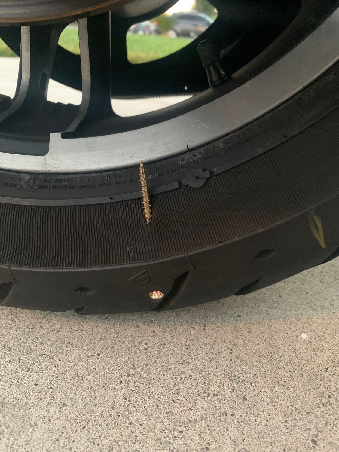

Old Oct 11, 2020 | 10:13 AM
SS FLHX's Avatar
SS FLHX
Joined: Dec 2018
Posts: 351
Likes: 47
From: California
I must be crazy. Left this screw in the tire and put 5,000 miles on it. Still handles perfect
Old Oct 11, 2020 | 10:37 AM
heavymetalthunder's Avatar
heavymetalthunder
Joined: Jan 2008
Posts: 5,202
Likes: 792
From: Kansas City, Missouri
You have more ***** than I do. That would have been in the garbage ASAP.
Old Oct 16, 2020 | 11:14 AM
blazzent45's Avatar
blazzent45
Joined: Oct 2018
Posts: 260
Likes: 77
From: Glen Burnie, Maryland
I've put around 3000 miles or so on a rear tire that I used one of those mushroom plugs in with no problems or loss of air. But you, my Lord you must have ***** of steal.......lol
