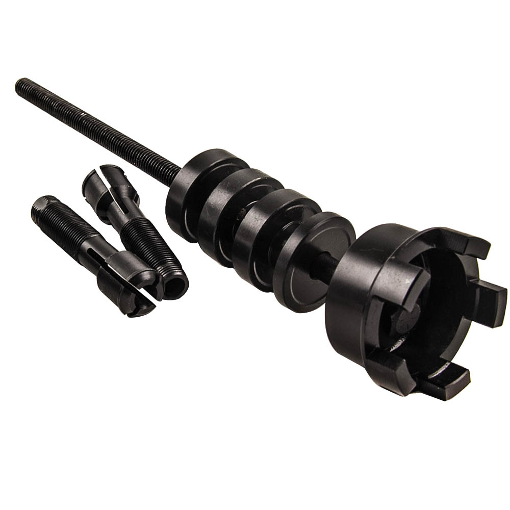

Did you install the bearings? ... if so, what Tool we're you using?
Old Apr 1, 2020 | 11:21 PM
mirrmu's Avatar
mirrmu
Joined: Jun 2010
Posts: 1,368
Likes: 27
From: Australia
yes, used this tool

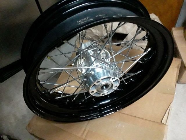

Here's a wheel that represents yours. Check to see if you have approx 4.25mm bearing depth. ... (we're using the end of the "Spigot" as a Reference)
Unless you've changed something other than the Like-for-Like wheel, you're Not doing anything Custom ... Stock OE Wheel, bearings, spacers, caliper bracket ... you should Never need a Shim or have to change spacers to make this work.
Either there's an installation problem or damage has caused a dimensional change in the parts.

ok pulled out the pulley side bearing and checked the right side bearing, It did move in and bottom out
checked measurement and have approx 4.25mm
the axle sleeve and new caliper mount all measure up same as 2010
will get wheel back on tomorrow
