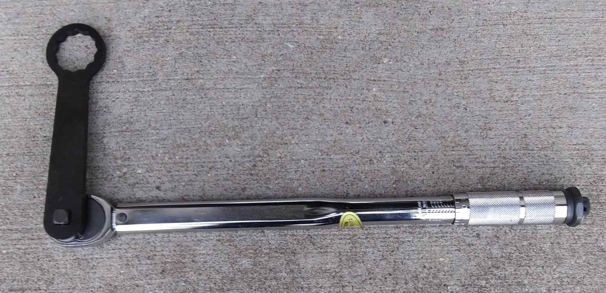

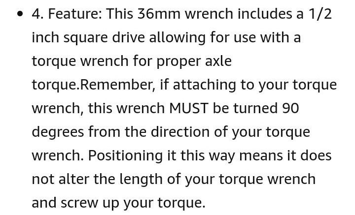

Keep this in mind when using a torque adapter.
Awesome Barney, I had asked around if this combination of tools would alter
torque, the best answer I found was a couple lbs difference , but
I found no information indicating that a 90 degree interface was key,
excellent to know this now, Thanks.
