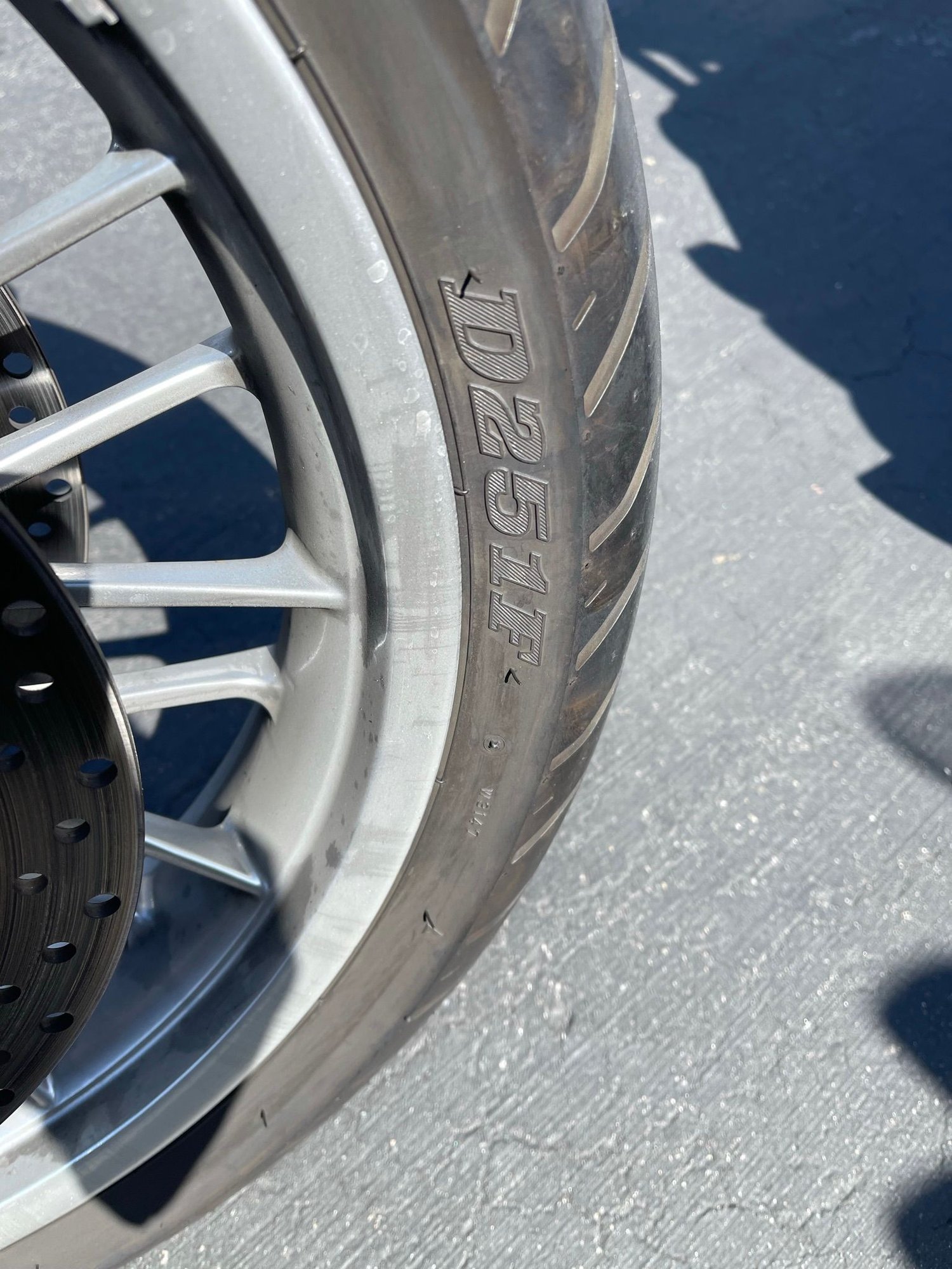

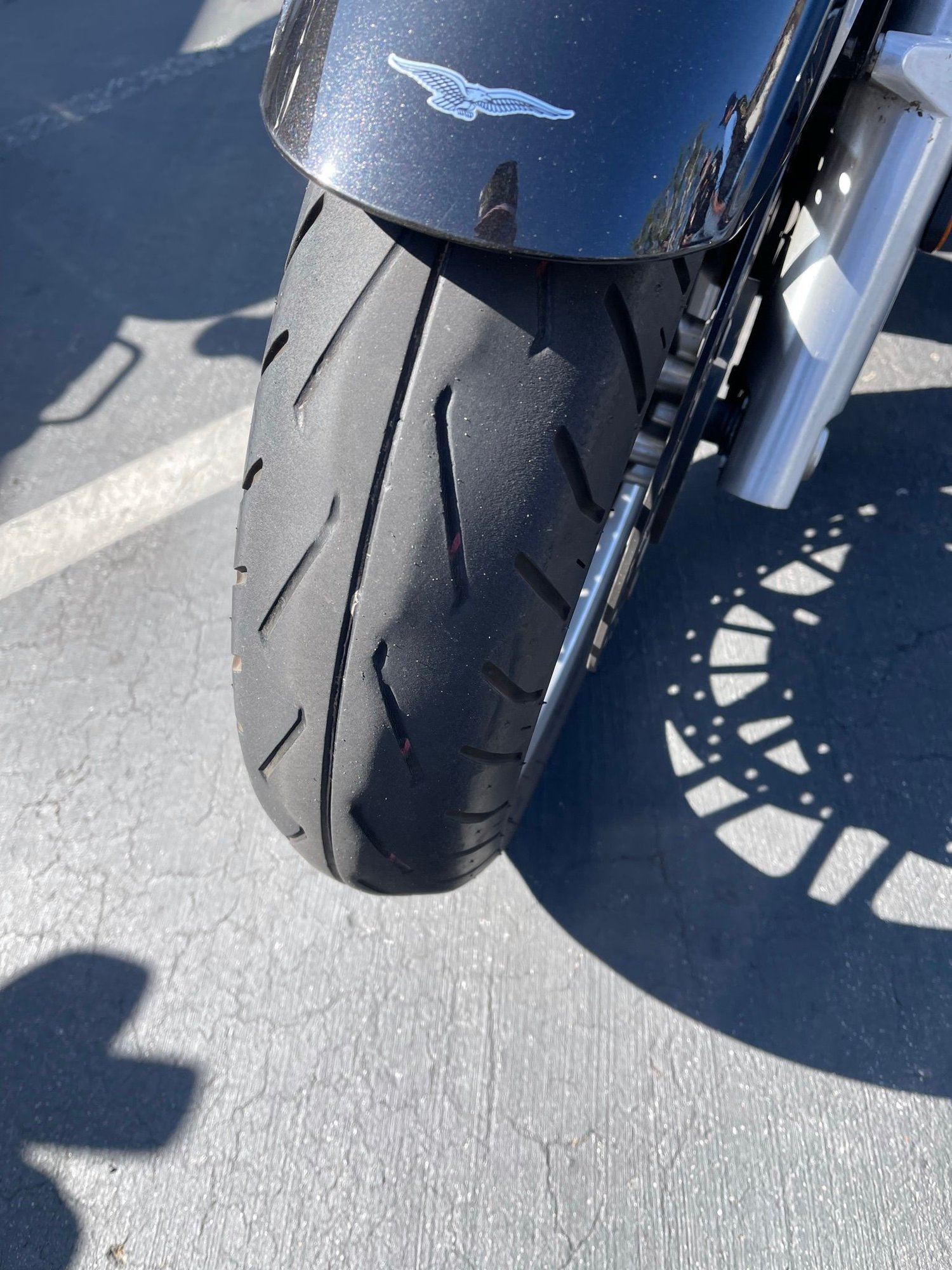

Was at a an event today, and saw this front tire on a fairly hew Moto Guzzi. Can you say cupped?

I bet he gets a little vibration out of that
just with the little cupping on the rear of mine, I can feel through the bars

The guy is an arrogant *******, so I didn’t bring it up to him, because he would have gone into some anti Harley tirade, with a bunch of insults and verbal attacks thrown in. If it was a safety issue I’d say something. But, I agree, with that much cupping his dentures must be bouncing in his mouth.

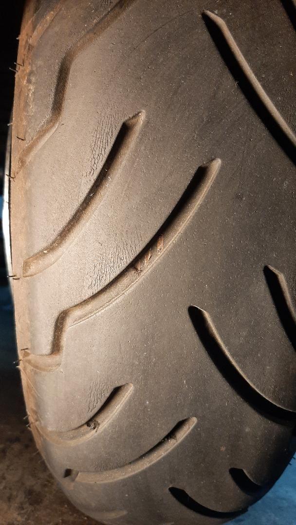

[QUOTE=gonemad;20260625]I’ve got 12k on the OE’s. Cupping and howling. I’ve got some new American Elites sitting in the garage that I’ll probably put on later this winter, but not while I have 4-5/32nds still on the current tires.[/QUOTEI
American Elites Get ruff on the edges also. These are mine with 4K miles, I was told it is Chaffing where the soft and Hard rubber materials meet.
The Chaffing (cupping) on my American Elites are from Driving that fine line in the twisties on a hot day, hot pavement.
I had to Edit and add what Dunlop Customer service person told me Quote "
This appearance is a superficial “chaffing” of the compound that results from a combination of operating conditions and road surfaces. The location on the tread face corresponds with the outer edge of the contact patch and occurs from the tread face deflection with the road surface. We have found that inflation pressures and / or load seem to be the most influential, but none the less the condition is limited to the surface of the rubber and does not affect the overall safety or performance of the tire"
