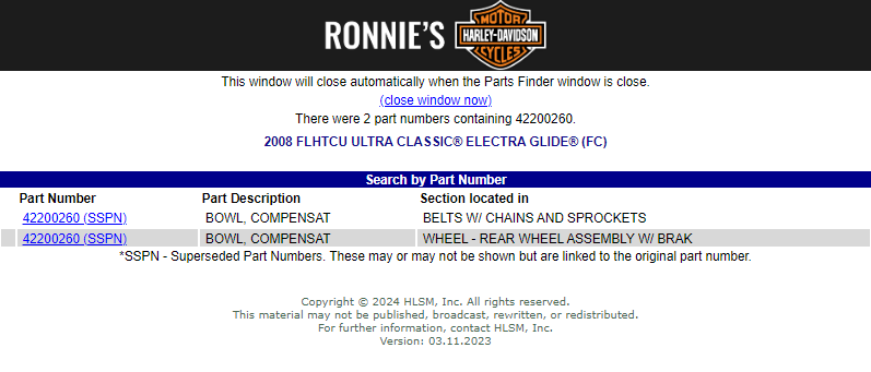

Originally Posted by Ohio HD
They still sell them, part number 42200260.
I believe that's the foreign part number. The US part is: 40560-05. It is the same part, but you'll only get search results from other countries searching for that PN. Either way, there aren't many around. I'm having the same issue as the OP and I FINALLY found a set of 08 Spoke wheels to replace my damaged hub (I wasn't willing to risk those first few threads being missing on the final drive). Now I found the remnants of either the inner wheel bearing when I pulled it all apart. It almost looks like a bearing retaining clip. Either way it's not on the parts list so I may still be a couple weeks from being back on the road. BTW just as a side note that I do not recommend...I had a harley tech tell me to just throw star washers on the damaged bowl and run it. I'm a risk taker, but not that much of a risk taker. This was already to difficult to source parts for to have it happen again.
I know what Google shows, but the fact is that part fits the USA version of the 2008 touring bikes, as well as several years of Sportster models. See the link below, and the models that the part fits.
https://www.bunburyktm.com.au/part/harley-davidson/42200260
https://i.imgur.com/bBkpuMj.png

Oh yea. It's the same item. I see on the chart that it's the superseded part number. 40560-05 is just the original number.
