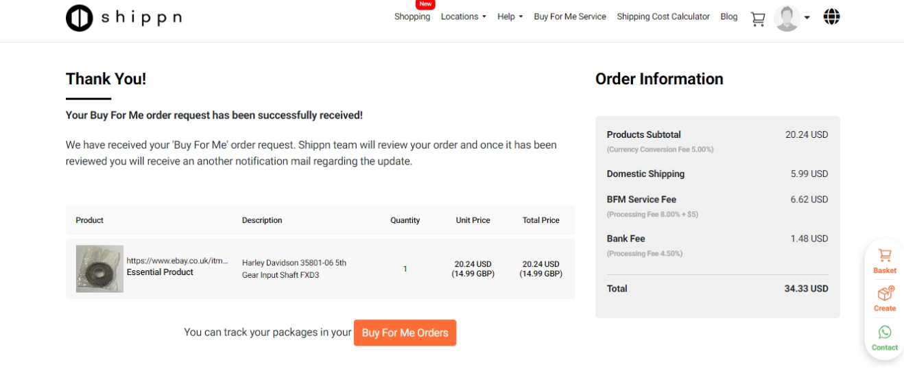

It's easy, just create an account, then you create a purchase item with the web link. They'll get back to you with their fee and shipping from the seller to the buyer. Then after they receive it, there's of course another shipping charge to the US. In my case the seller in Wales shipped to the buyer in London. The buyer shipped to me, I was able to select how I wanted it shipped, then pay that amount.
https://www.shippn.com/en/home
Below was my initial charges, then there were the shipping costs to the USA. They base their fee on the item price.
