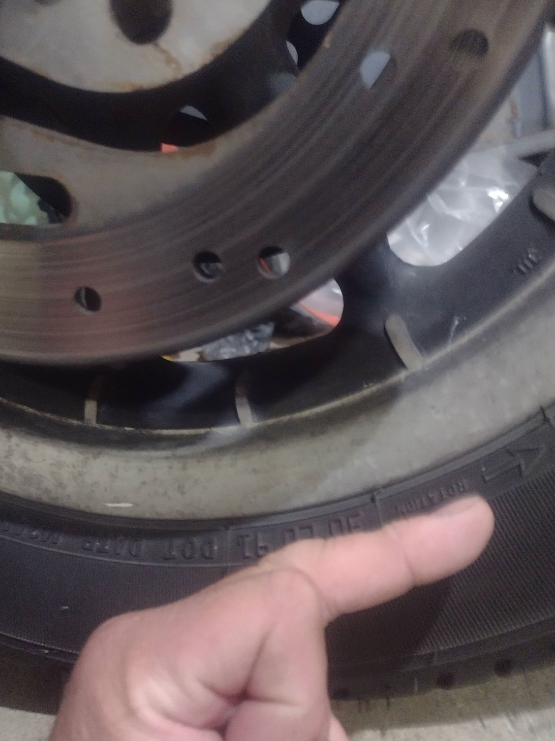

The dealer mounted the tire. I should have double checked. Just doing this thread to maybe help someone.
Despite what people say here, I am sure many people just go by valve stem on wheels that have valve stem to right.
Despite all your cocksureness some people here could have done it, and never known

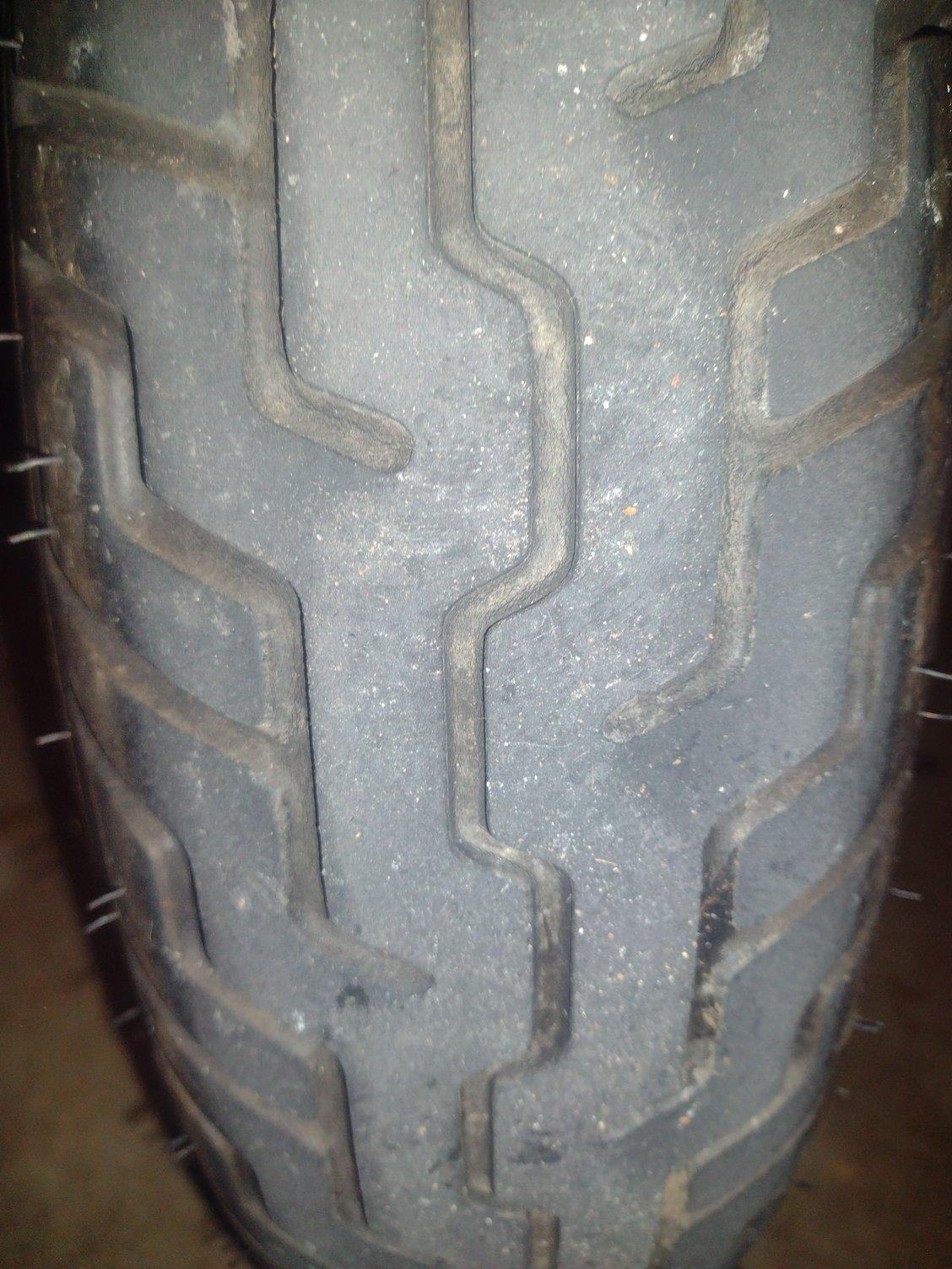

18k miles. Not sure what is so hard to believe. You look at tire pattern, the center doesn't really seem to directional,to me.

Ya tire was mounted wrong on wheel. Some people don't know the difference between tire and wheel, and some I don't think have ever installed a wheel. The tire has nothing to do with the bike. Duh. On touring bike I don't even know if it matters which way you mount the wheel, either.
Again, I can take some ball busting, laugh at myself. But check dealer mounted correctly.

Maybe the tire pattern is not directional, but the internal tire design IS.
It's all about the forces generated in riding a MC.
Thats why anyone putting a wider rear tire on the front has to reverse the rotation, because of the forces.
