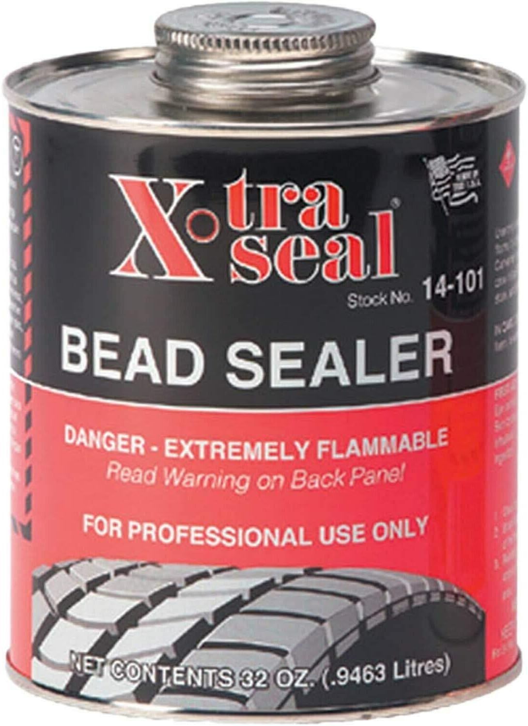

Check the stem too, that was the source of a leak on a tubeless wheel on my bike...discovered that because it was leaking slime I'd put in the tire.
Bead sealer can help in some cases, like when an aluminum rim has some corrosion in the bead area. It goes on with an included brush and any excess is easy to clean up, it peels off when dry.

^^^ Used this many time on aluminum wheels to seal a bead leak ^^^

He said the lip of the rim was peeling, put a tube in it and I’m good to go
