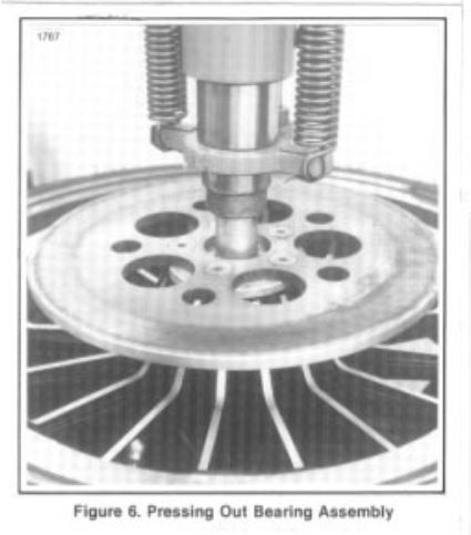

Is there anyone out there that can tell me if I have to take the brake disk off to fit a new needle roller bearing in my 1981 FLT or can I fit it with the disk still on the book I’d a bit vague on it there seems to be a ally disk in front of the C clip is it the spacer behind the disk it seems to have a grove as if it a separate disk Some one must have had a go at one some time pleas one and all

Apparently you don't have to remove the disc ... Here's a pic (see below) of the needle bearing being removed using a "Press". Harley uses "Special" bearing pilot pieces along with the front axle (even on the rear wheel) to install the bearing/race, but you can probably get around that.
I would post your question where the Shovelheads live on this Forum HERE

I think you have saved me a lot of money I was going to cut up the disk weld the studs to the bits and a bit of rod to the bits so I could get the alien bolts moving but there seems to be a bit of spacer or some thing to cut out to get the C clip out I will weld a big nut to the bearing or a bit of flat and press it out I like it when a plan comes to gather I will let you know if all goes well or knot I have some one going to give me a prise on a disk spacer and five bolts I hope he will knot be to pist off with me thanks a lot lot lot mate

yes you are right but my needle roller has aluminium collar round it iv tryed to drill it thinking it was just a collar knot looking good now

I have sorted it out made a puller that got in the back of the case and iv got a set of bearing on the way so with fingers X I hope all is on track so thanks to all how that have helped me and looked things up for me I hope you all have a happy exams and a happy new year to all HO HOHO
