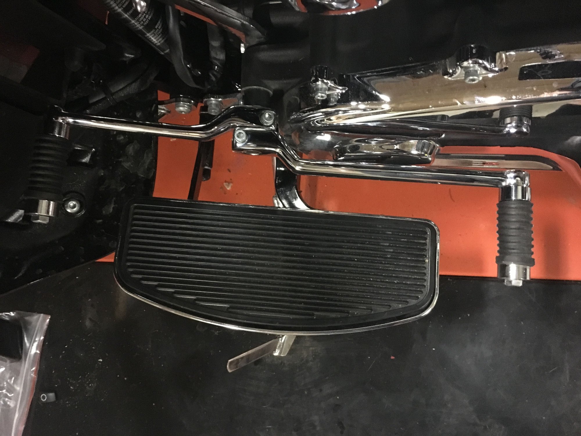

Where did you find the extended heel shifter? Have a link? Thanks
softbrake and kuryakyn make one.
I replaced both levers with extended kuryakyn. This gives full use of the floorboards without having the levers pointed to the sky. Best mod I ever done!
HD Billet Extended Reach Heel/Toe Shift Lever

Can get a stock looking extended shifter for about $40 at Dennis Kirk or JP https://www.jpcycles.com/product/510...SABEgKYCfD_BwE
