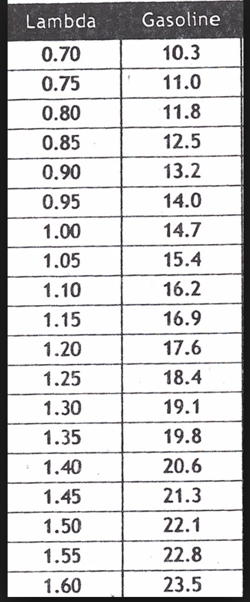

From:
What afr is 980 ?

Hope this helps
Wow did this from my phone, sorry for the size of the picture, you don't need your "readers" for this one...

AFR = Lambda x Stoichiometric or Lambda x 14.7

Closed loop is between .976 and 1.012 lambda. 14.34-14.87 AFR
