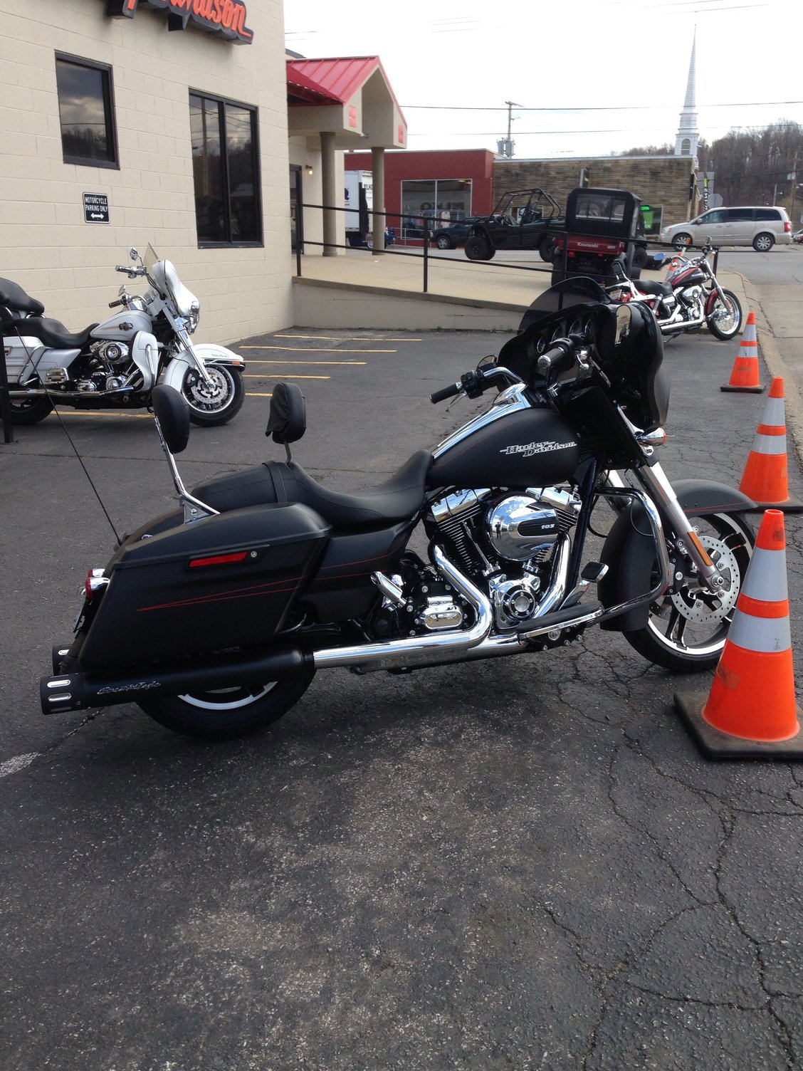

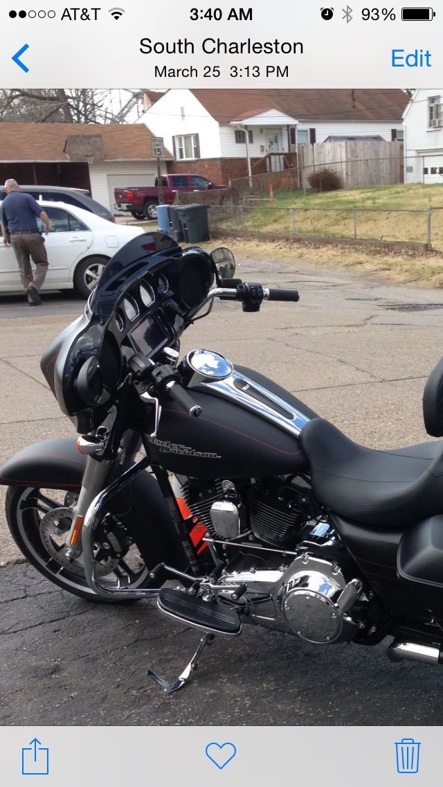

2014 SGS with the HD reduced reach bars..

I hope the pics help... Dealer did the install and nothing extra was needed. I'm 5'8 and these bars fit me perfectly, no complaints.
