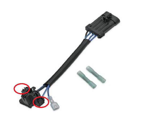

nothing is easy for me. I am trying to connect the plug from the JW speaker light into the connector from the HD LED wiring harness adapter and it is really tight, I can't seem to get the parts to seat. There are 2 ears on the harness connecter, right and left, that can be pressed in, do you have to squeeze these as you assemble the connectors or is there some trick to this?

Fairing Models
1. The two capped wires are not used. Secure to the jumper
harness with electrical tape.
2. Connect the LED adapter harness to the main harness
connector
NOTE
The fourth wire on the LED adapter harness is not used in all
cases. It is for the position light on some headlamps.
3. Follow the instruction included with the new LED headlamp
to connect and finish headlamp installation.
4. Install main fuse. Follow the instructions in the service
manual.
They click onto the OUTSIDE of the LED. There should be little dog ears for them to click onto. As long as you are talking about the ones in the red circles.

yep, that's them. I finally just put a little electrical contact lube on the parts and pushed the connectors together. There is still a small gap left. It just looks a little funky but it works. It looks like you are supposed to squeeze the ears (in the red circles in your picture) when pulling the connectors apart. Anyway it is together. I aligned the headlight and had to raise it up maybe 4 inches from its original setting. Test drive tomorrow if it stops raining.
Yes, they lock onto the "bulb" to hold the harness in place.
