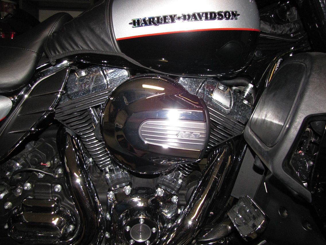

Sorry if this has been answered already, I didn't see anything by searching. My question is whether or not the back plate is really all that visible behind the stock cover? I wouldn't mind seeing some photos of those that have installed it. I'm really considering this intake, but can't decide which color to go with. Thanks...

We both have AN Big Suckers. I have the Kuryakyn Alley Cat Cover and the wife has the stock.

Nope, if you are looking at the one for the stock cover, you can't hardly see the backing plate.

Same set up with stock cover. You only see the backing plate when you look down at the side of the bike when your sitting on it or looking over the stock cover. But we spend more time on it and side of it so I got the chrome one.

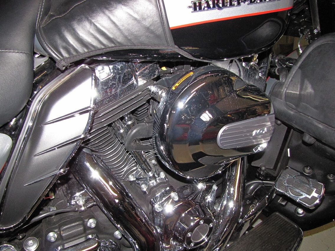

Hey man, witch set up sticks out further ?

Vernal I see you still have the throttle body support plate attached behind your air cleaner against the cylinder heads. That can be removed.
The OEM by 3/4" Thanks for your help choosing the cover!
