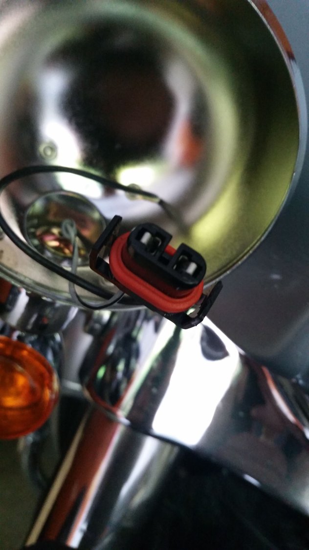

Trying to remove leads from Deutch connector. This one's different than others I've dealt with. So, what's the trick???
Connector for auxiliary lights.

The 2015 Elec. Diagnostic Manual says it is a 2 way Delphi 280 Metri-Pack Sealed (BK)
No instructions given for 280 sealed.

Above the folded part of the terminal you use a tool to press the lock down. Paperclip works too...
http://www.jpcycles.com/product/383-...ri5BoCZD_w_wcB

I used a paper clip and inserted along the outer edge of the female terminal end. Once I got it in right spot, the terminal slid right out. Thanks for the help.
