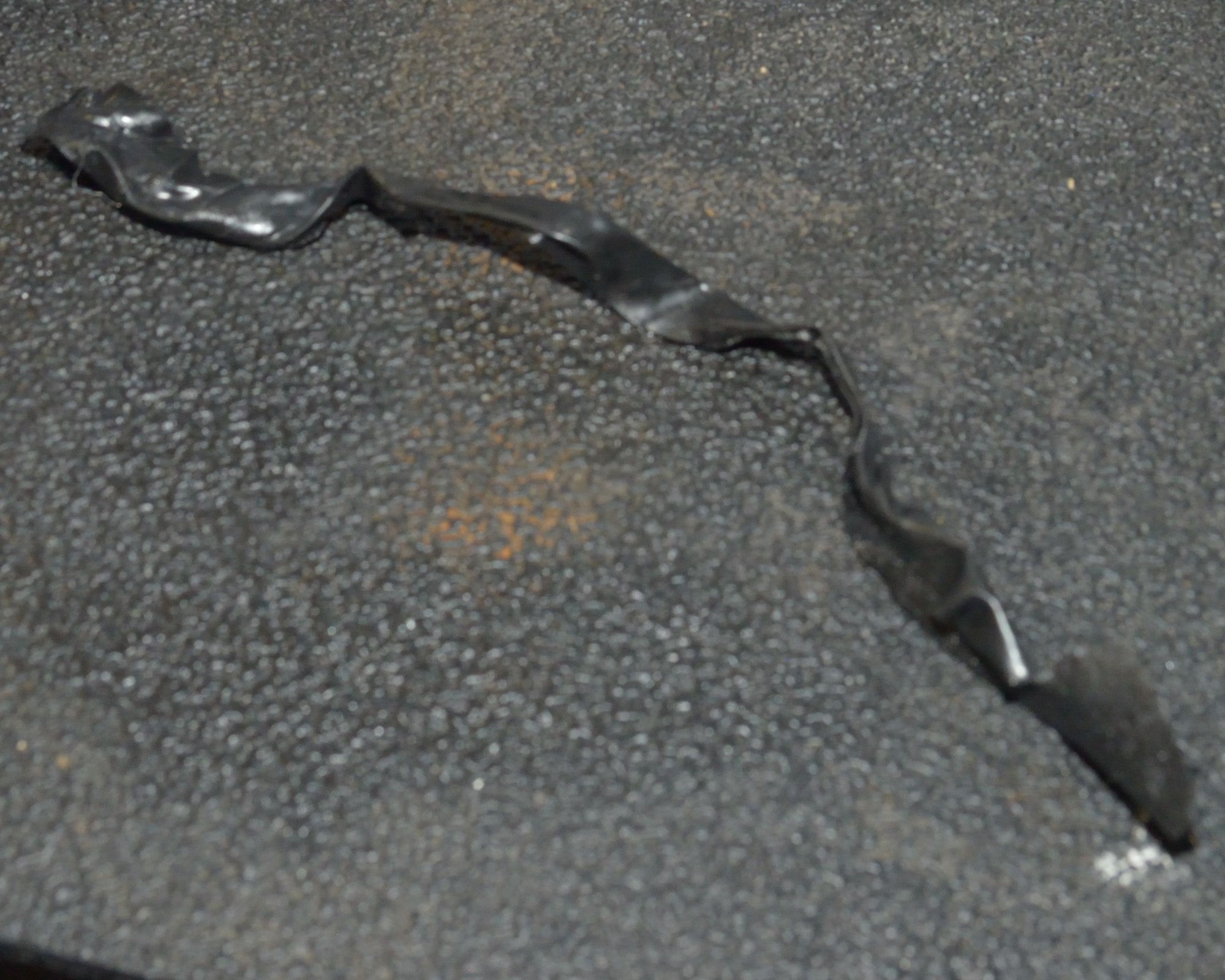

I got it back from the dealer with the same wire fault. So I decided to take on the task.I started pulling wires out of the access hole near the steering head. What do you know! I found a bunch of connector wires taped together with black tape. Looked amature too. It was kinda gooey but I got all the tape off. It looks like someone tried to hide a damaged kinked wire, There;s a a single white wire with a gray strip with a kink in it and the copper insert was pulled out from the plastic connector. I insured the copper connector back inside the plastic housing and no more wire fault. I spent at least 6 hours working on this issue not to mention all the hours of research and and time at the dealer. I feel Harley Davidson owes me at least $800.00 in labor cost

Notice the white wire with the kink in it. I only discovered the issue after taking off the black electrical tape (see PIC). When I pulled on the white wire the copper insert on the end of the wire came out of the plastic connector. I put it back inside the connector and the wire fault went away. Since I'm the first owner of the bike this must have been done at one of the two dealerships that had it because I don't think the manufacture would let a bike out of the plant this way. I got her at 155 miles this May so the repair job didn't last. Whatever the case may be, I found root cause. The dealer will now have to come up with a permanent solution and I have full warranty too.
