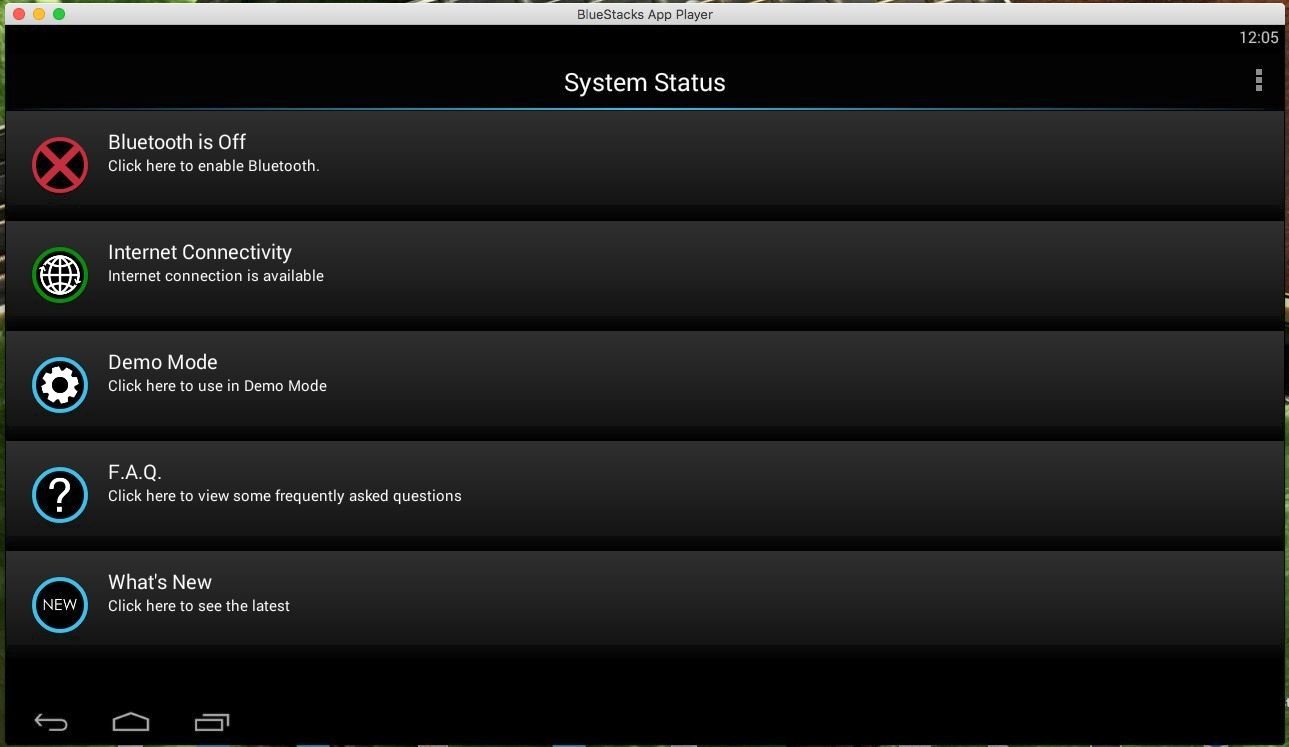

When you click the icon, FP3 app loads and looks like this:
You'll note that "internet connectivity" is shown as "available" (I guess that means "live"), but "bluetooth is off" -- because there's no FP3 hardware available for the software to connect to.

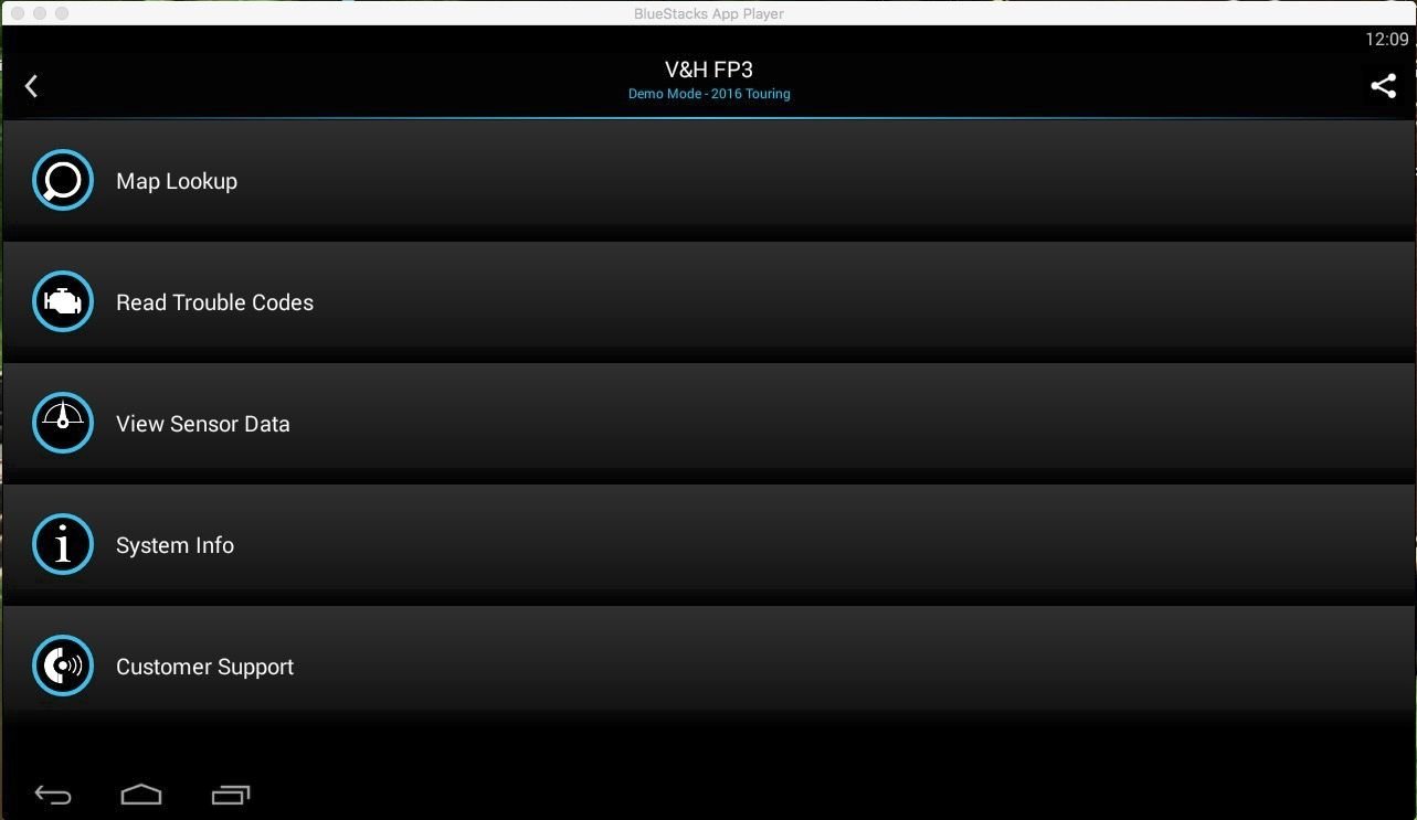

Since I don't actually have an FP3 or a Rushmore bike yet, all I can do is use the "demo mode":

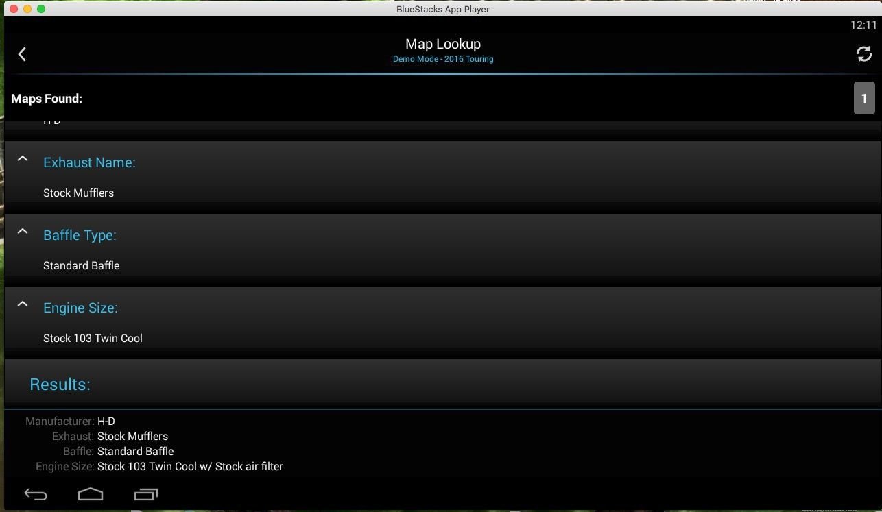

I can then lookup a stock configuration map:
... and "go through the motions" of installing it.
