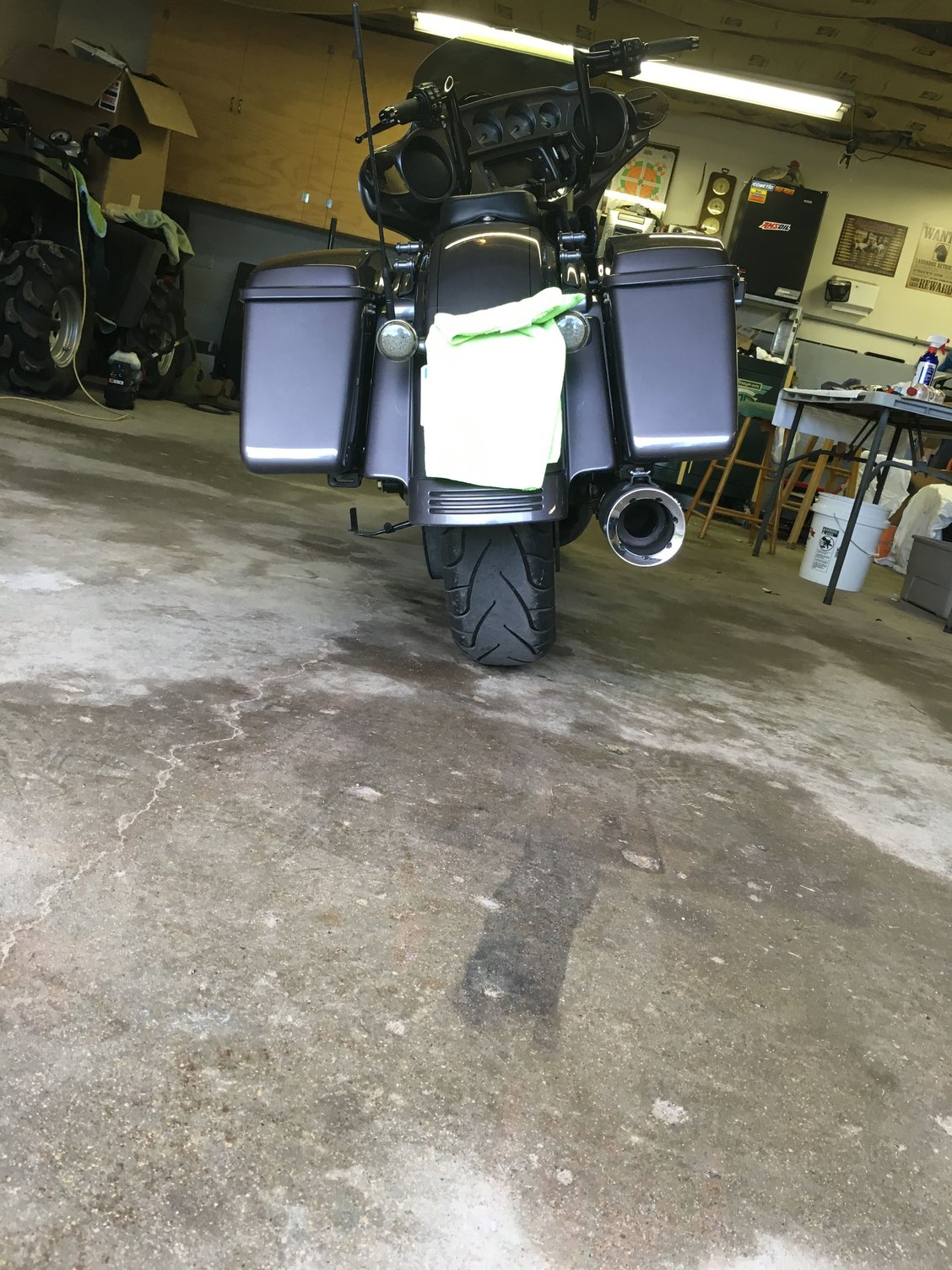

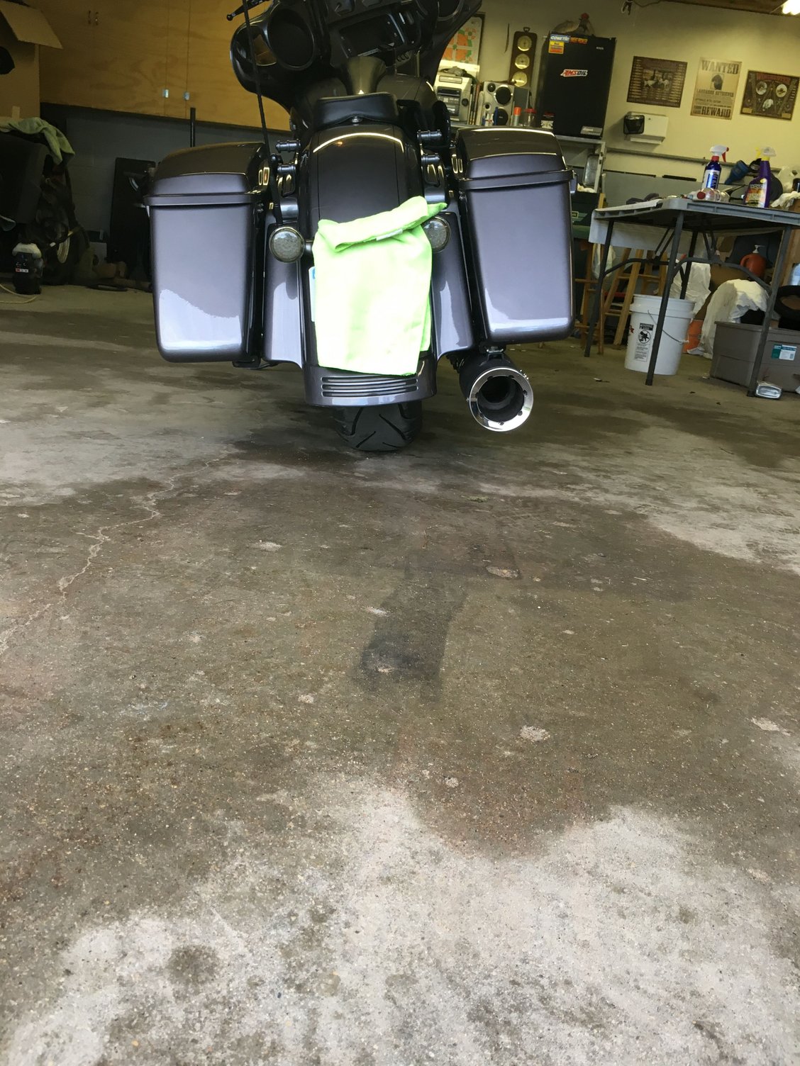

Diy rear air ride uses Monroe shocks. When deflated the bike lowers 2-3 inches. Here's an example. http://dirtyworks-kc.com/t/air-ride

Height difference between aired up and dropped. Up is higher than stock and not comfortable.
