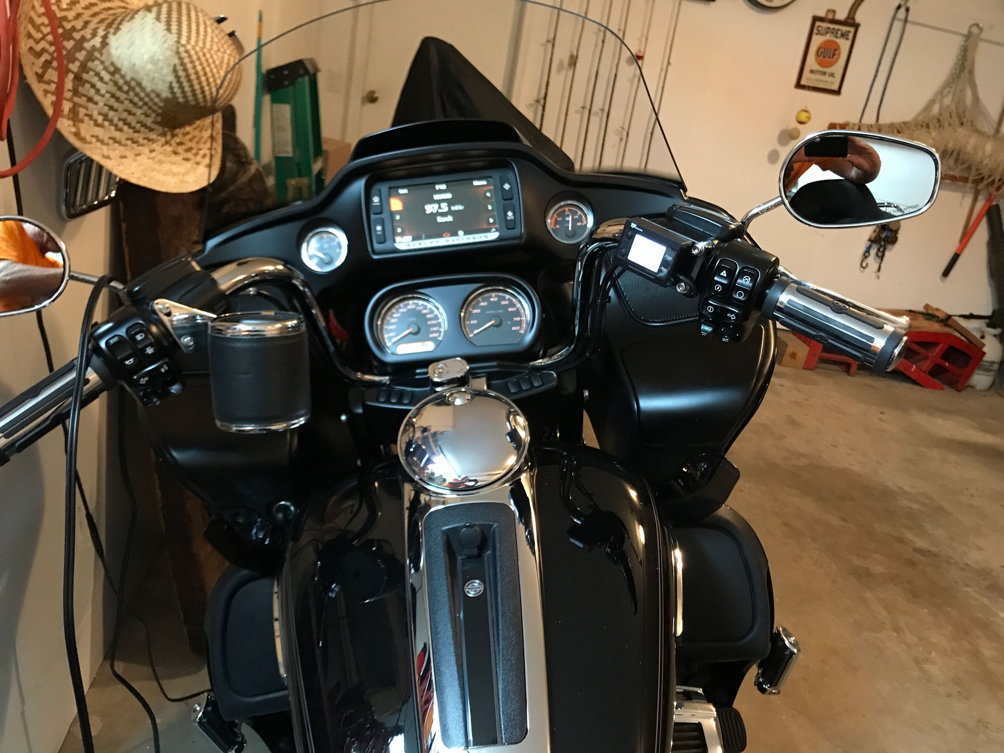

I have a Fobo system that I bought as a back up in case the 'In Tire" sensors for the Orange Electronics M203T TPMS system didn't fit inside my '16 Road Glide Ultra's factory rims. The sensors fit without any issue... now I have a Christmas present for a buddy �� The M203T has its own display and uses in tire sensors that fit in my factory rims no problem. It does not require any movement to register tire pressure. It is accurate to within 1/2 pound of what my tire gauge shows. It displays tire temps also, and you can set ranges for pressure and temp for each tire that will send warnings if they go out of that range (display turns red).
You have to figure out how/where you want to mount the display, because it doesn't come with a mount, other than double stick tape. To mount mine I used a scrap piece of 1/8" aluminum painted black and cut it to 2" x 3" and stuck the display to that. Then, using longer screws and standoffs, like some cup holder mounts use, mounted that in front of the front brake reservoir. Wired the display in so it turns off and on with the bike. Works like a charm and took less than an hour to install and wire up (after I had the sensors installed).
Warranty covers sensors and display for 2 years, The system cost $175.00 and replacement tire sensors are about $35.00 each. I got it thru RRRToolSolutions. I'm happy with it... It's still new, but I just made a 2500 mile run up to the Black Hills and back, in and out of rain and temperatures from 60 to 105, it operated as I would expect it to... now just see how long it holds up lol It cost more than the Fobo, but thought I'd throw it out there if anyone's looking for an alternative to capping their valve stems or using their cell phones.
Below is how I mounted mine... sure a more industrious person would come up with better ideas.
