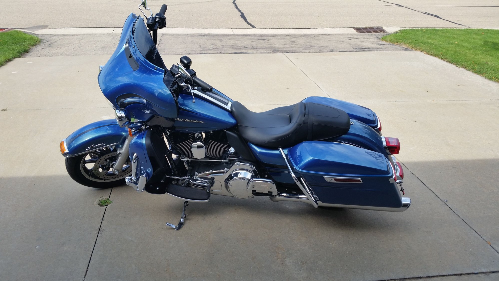

Here are my thoughts, some of which have already been mentioned.
1. Do NOT attempt to reinstall the tour pack by yourself. Your fender will thank you. Seriously. You might think you can do it by yourself, feeling all manly and stuff. 10 minutes later you'll be crying in your beer over the new "accents" to the fender.
2. The black clamps on the side of the quick disconnect bracket can be replaced with chrome ones, or even chrome locking ones with keys. Think about that before doing the installation.
3. HD has a nice cover kit for when the tour pack is off: http://www.harley-davidson.com/store...ware-cover-kit
4. If you're thinking about adding any more lights to the tour pack, or anything requiring wires to the bike, make sure you take into consideration that the wires will need to be disconnectable (I'm making up words as I go).
I agree the bike feels much more responsive and nimble when the tour pack is off. I couldn't believe it. But my 6 year old grandson likes to ride with me, and the I felt better with the tour pack on than just using a back rest for him.

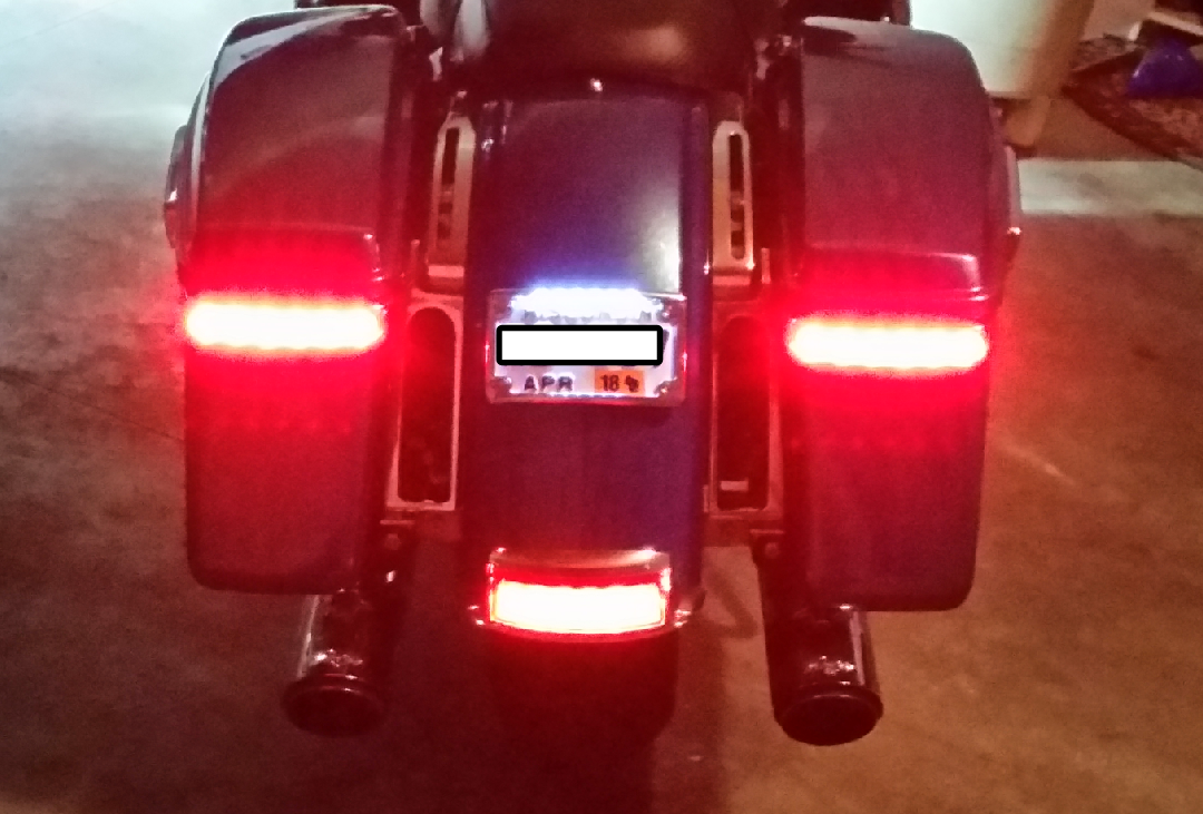

I bought and installed a Kuryakyn plate mount Has an LED light that wires to you taillight. Had to drill the fender to mount but no big deal to me since its permanent.
Plus it's cleaner looking than the shitty one the QD kit comes with. Added the LED brake light for a Road King so there is no window for the plate light on the top of the light.
