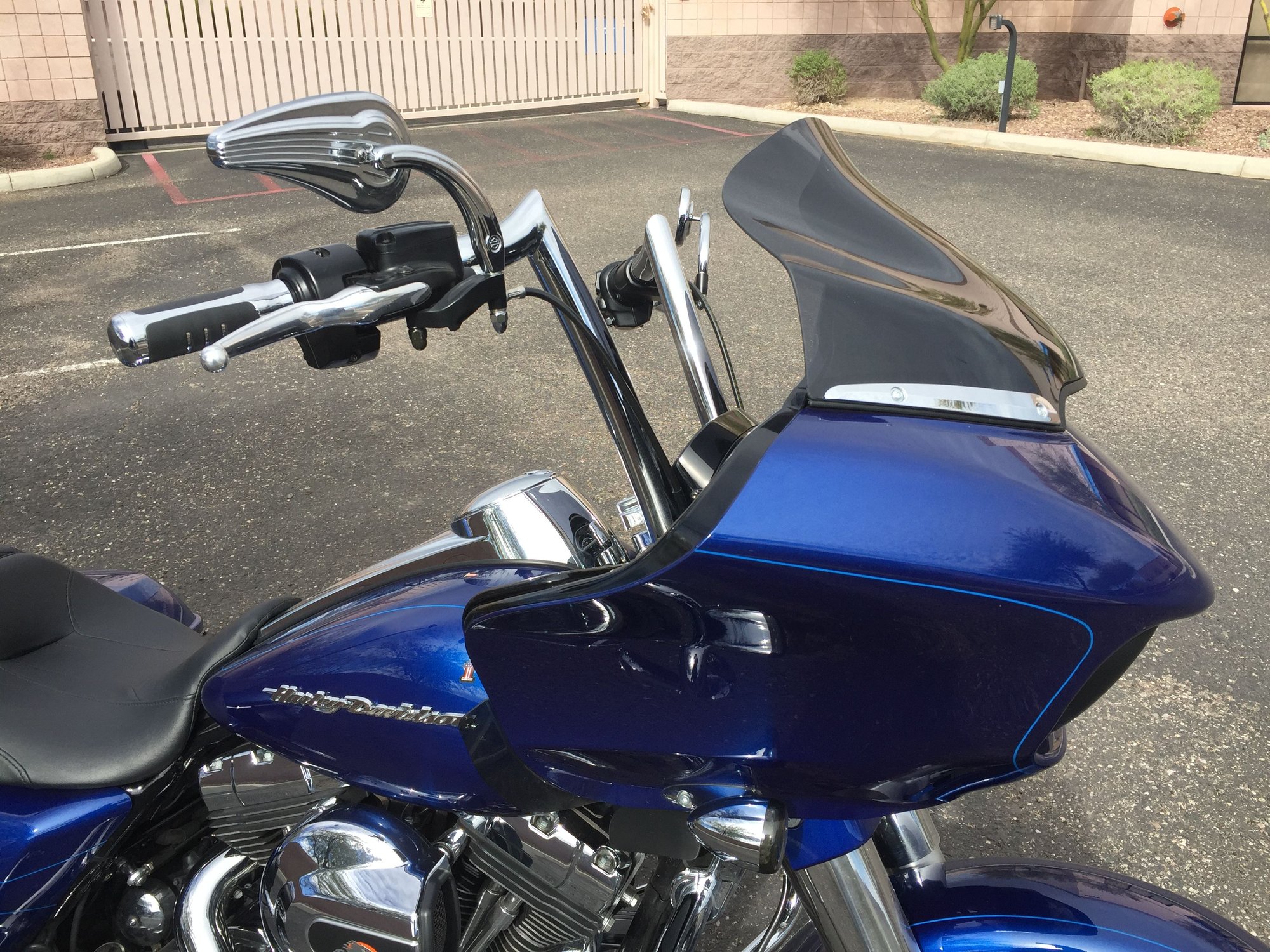

The 14 Malo fits perfectly without adding anything. But like mentioned before there's a couple zip ties to cut. Depending on your windshield style the bars might touch when turning so adjust accordingly.

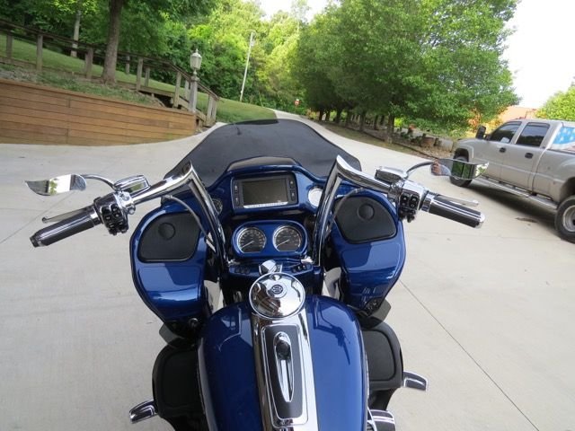

I put 43800 miles on the factory 47 14" for the 15 Road Glide. Nice finish, a little wider than Yaffe Monkey bars, and a couple inches shorter than Yaffe 14" monkey bars.
