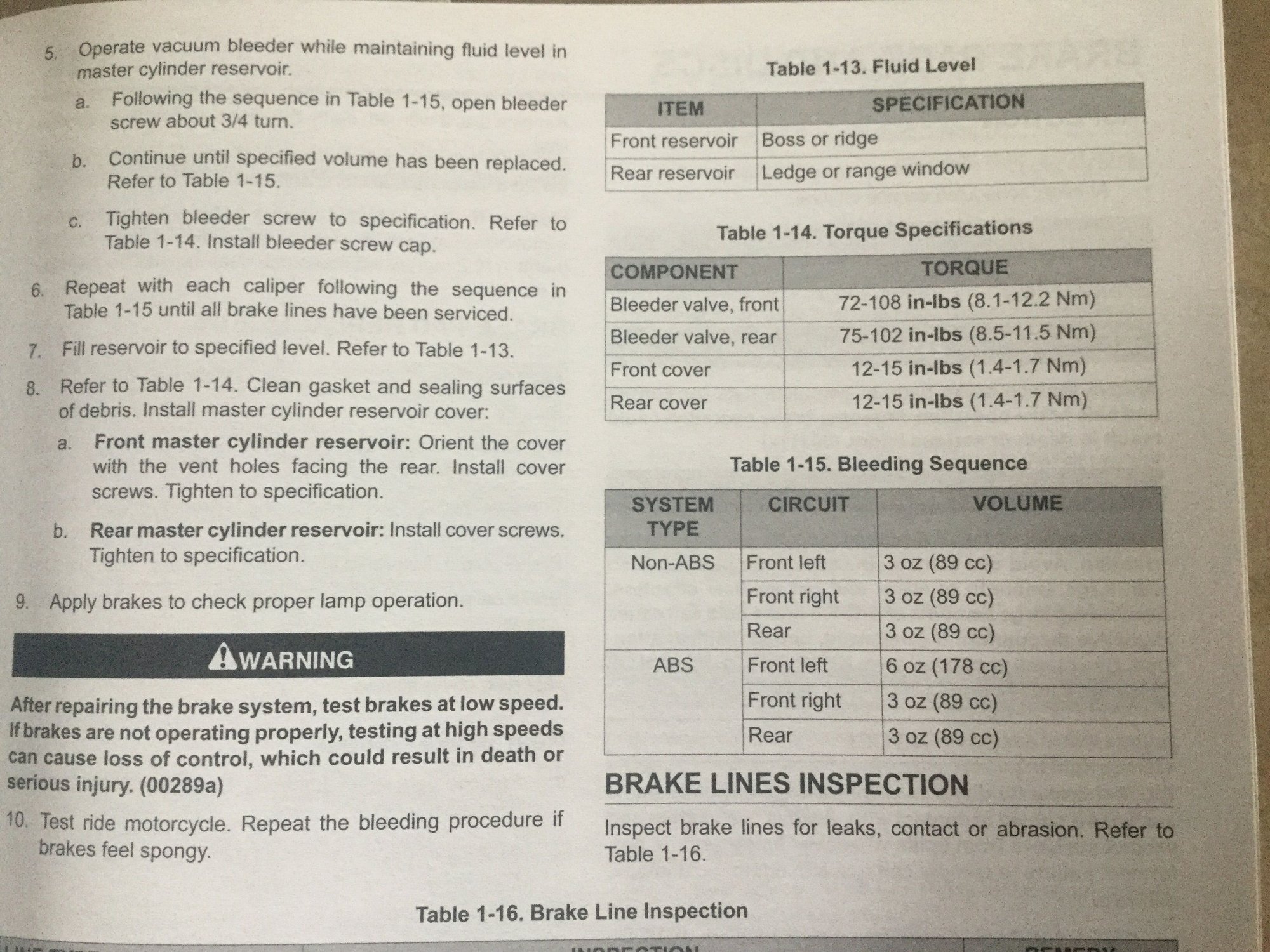

To those who have done the procedure approx, How much fluid is needed?

I bought the small bottle and it was plenty. Once you open a bottle you are supposed to use it or toss it. So I purchased 2 small bottles and only used the one. It was more than enough for the job.

have not ridden it yet here's what i used
not sure really how much is needed i went thru almost two bottles to be certain

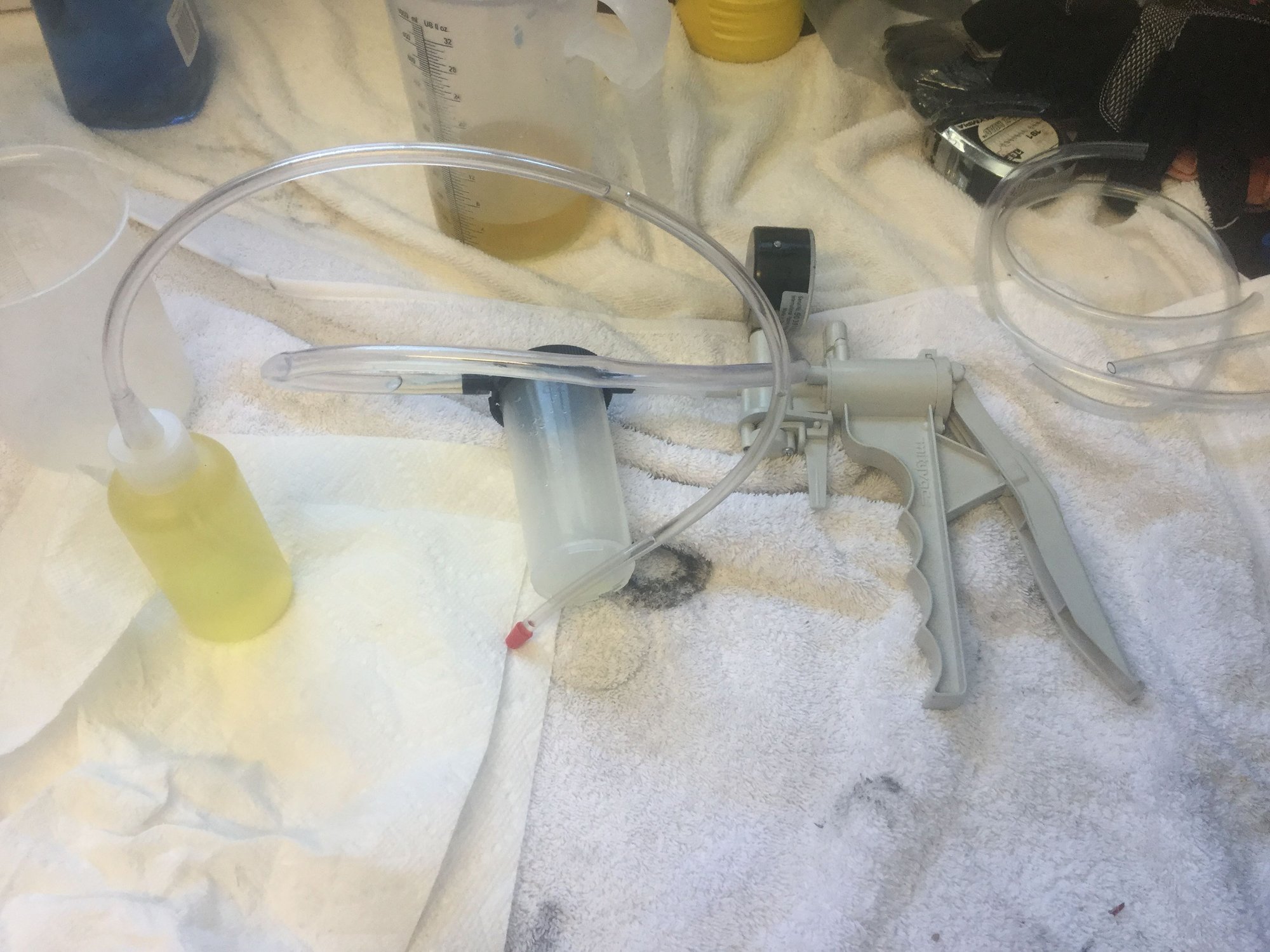

I found a "Snuffer" bottle at Cal Ranch and added a longer line to refill the reservoir.
Protect painted parts.

It's hard to see but the tubing goes to the bottom of the bottle. When you stop squeezing the bottle the fluid in the tube returns to the bottle.
That's sweet!! I like anything that helps keep the fluid off the paint!!
