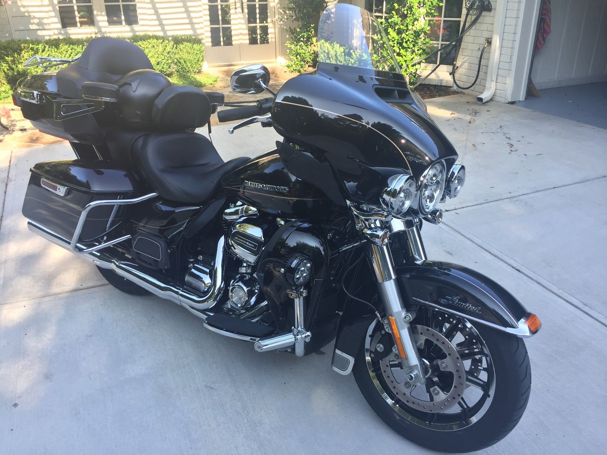

Here's an alternative. Cirius lighting. Ya don't see any wires with this setup, nor do ya see any hardware holding them in place.
https://www.ciriususa.com/

Did you install the Cirius lights yourself? If so how difficult was it to install?

Dirt simple to install. Just need a few 1/8" drill bits and a tap for the crashbar. It's very hard steel and you will break a couple bits and taps in the process. Use the same switch setup as any other fog light setup. Your wires come out of the crashbar up under the neck where ya can't see it then right into a harness.

Well, I now understand your issue with my lights. Looks like you selected a product that meets your sense of aesthetics. The do look pretty bright, but w/o reflectors to focus the light & only 300 lumens each, do they provide sufficient illumination to put that light where it's needed for night riding?
My Darla's are 2000 lumens each of reflector focused light. Other than that concern, it's looks like a very good addition to your visibility lighting up front in a clean, compact package that allows the wiring to be hidden inside the engine guards.
To each his own; still like my lights & have no regrets with the installation. I'm sure you feel the same about yours.

The dual LED headlights provide sufficient light for night driving in most conditions. 80+ mph at night in rain is over driving them. The fog lights do fill in close in front of the bike but that's only useful so you can see what you're about to hit. These provide the additional visibility so others can see me.
