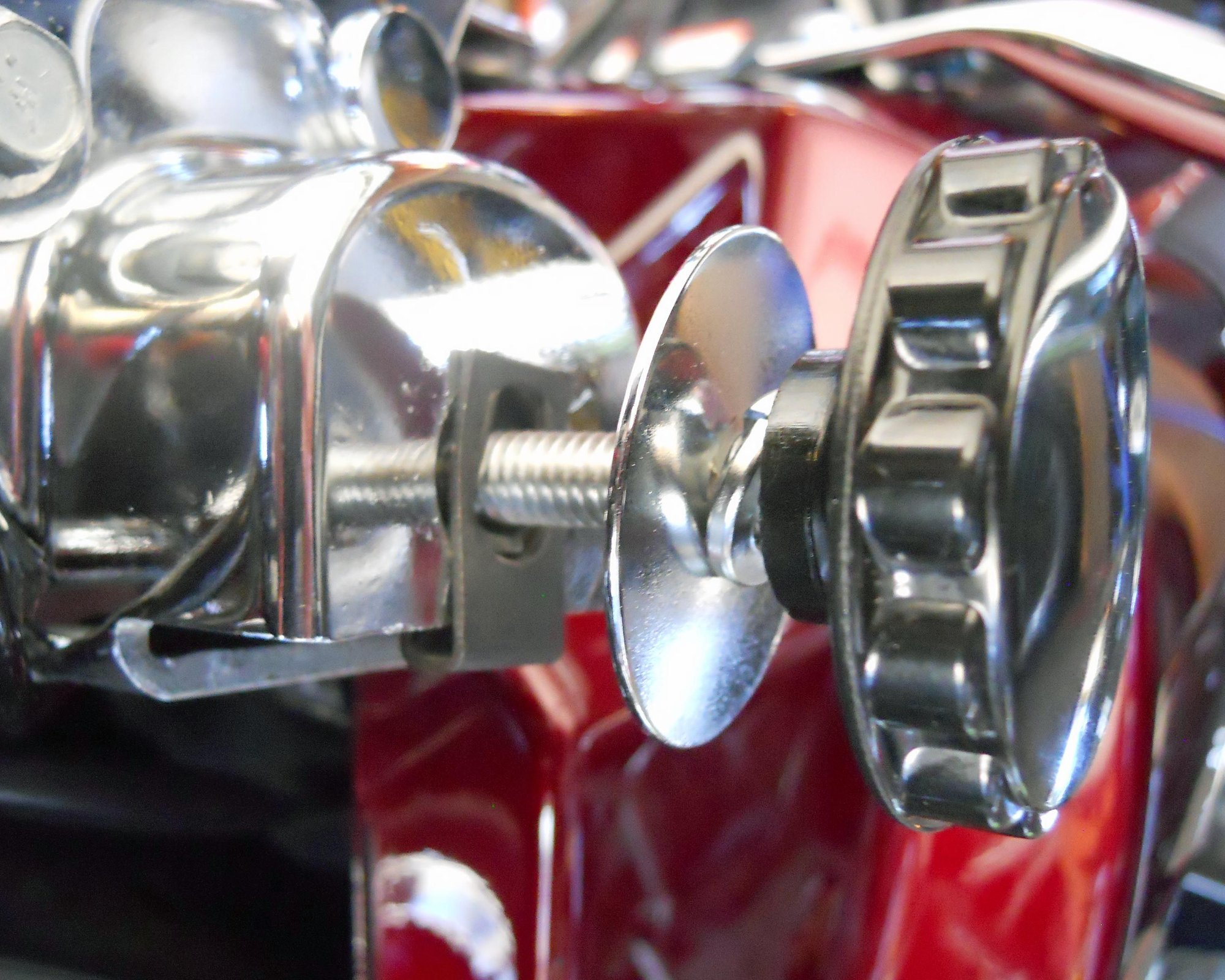

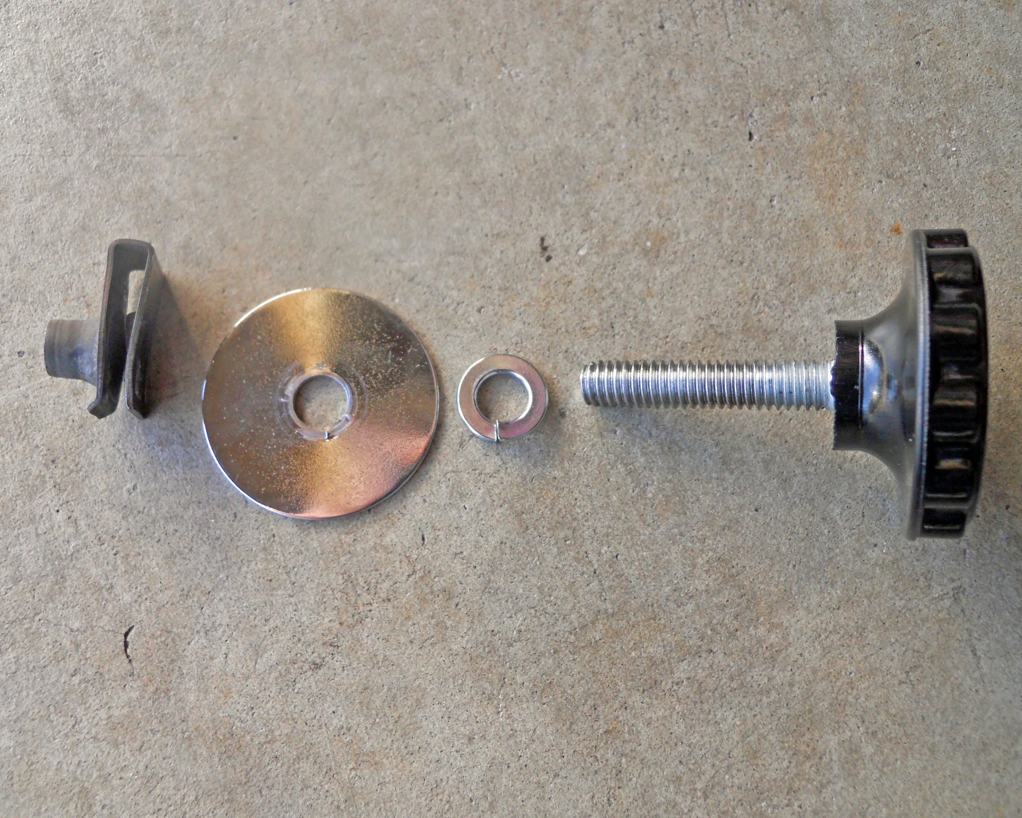

Put one in each Saddlebag. End of worries.
As installed.
Left to Right: Clip U-Nut, Stainless Fender Washer, Stainless Lock Washer, Threaded ****." />
5/16" X 18 Threads > Left to Right: Clip U-Nut, Stainless Fender Washer, Stainless Lock Washer, Threaded ****.

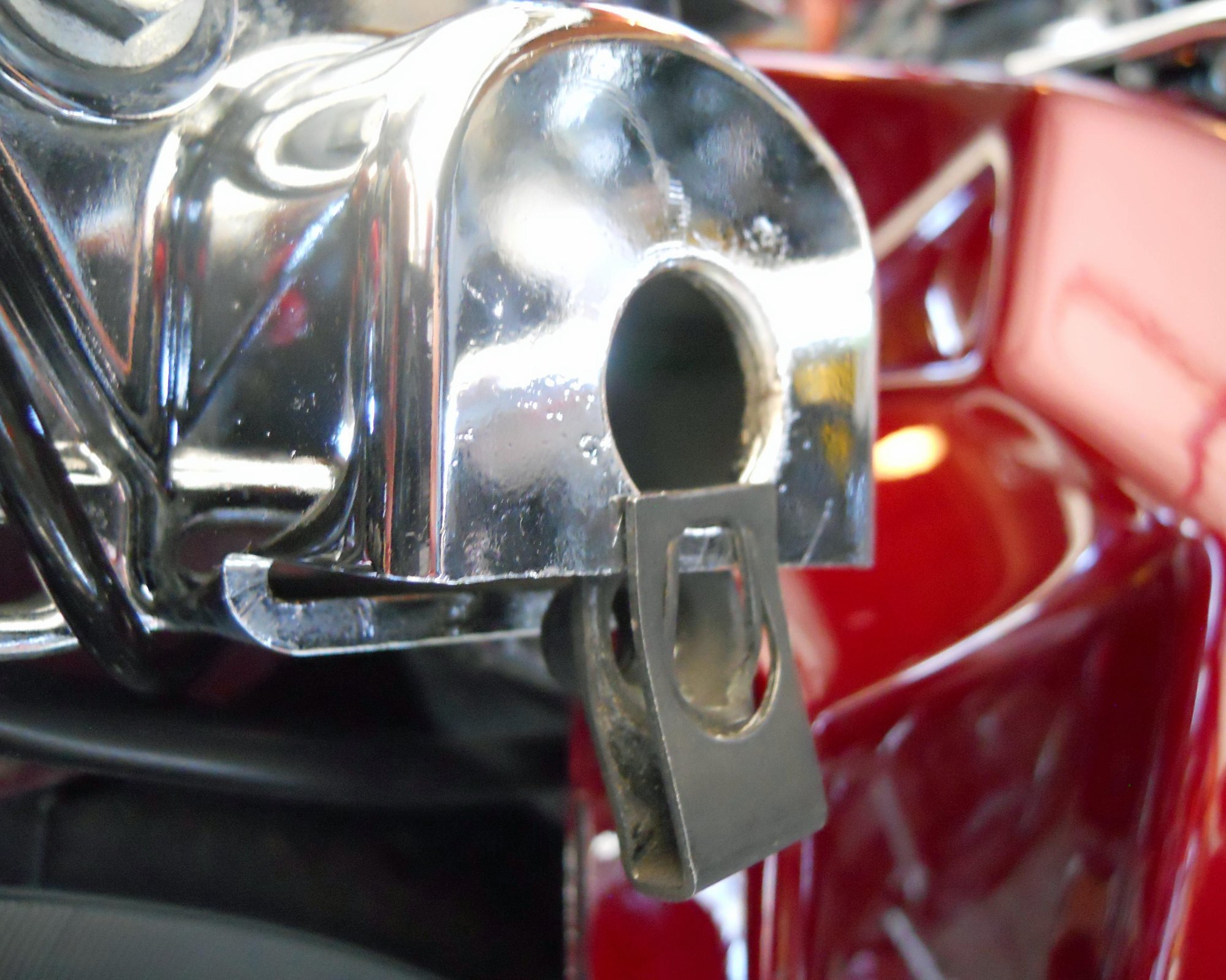

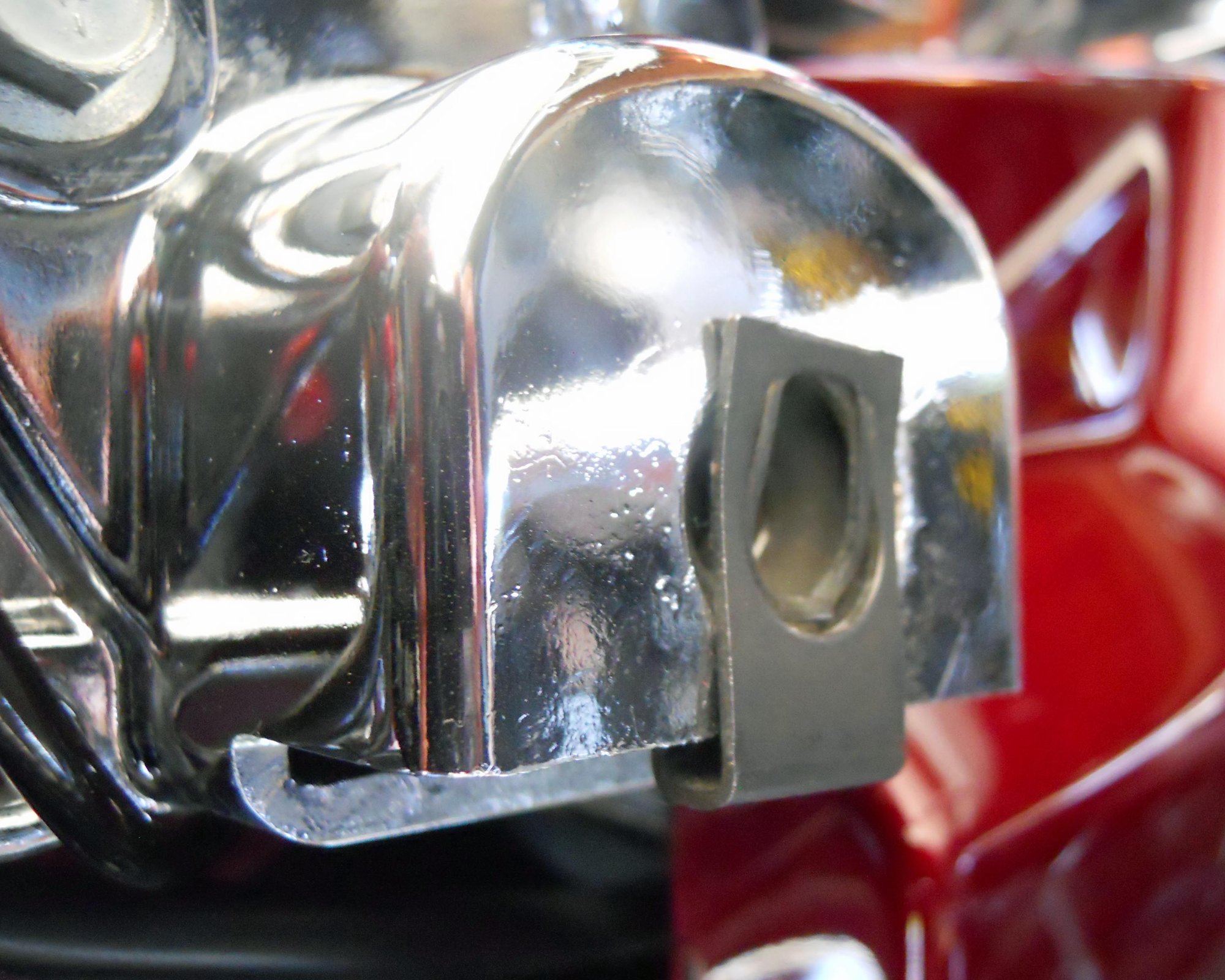

Remove Original Clip
Original Clip removed.
5/16" X 18 Threads U-Nuts
Install U-Nuts
U-Nuts Installed
Installation without Saddlebag.
Final Product.

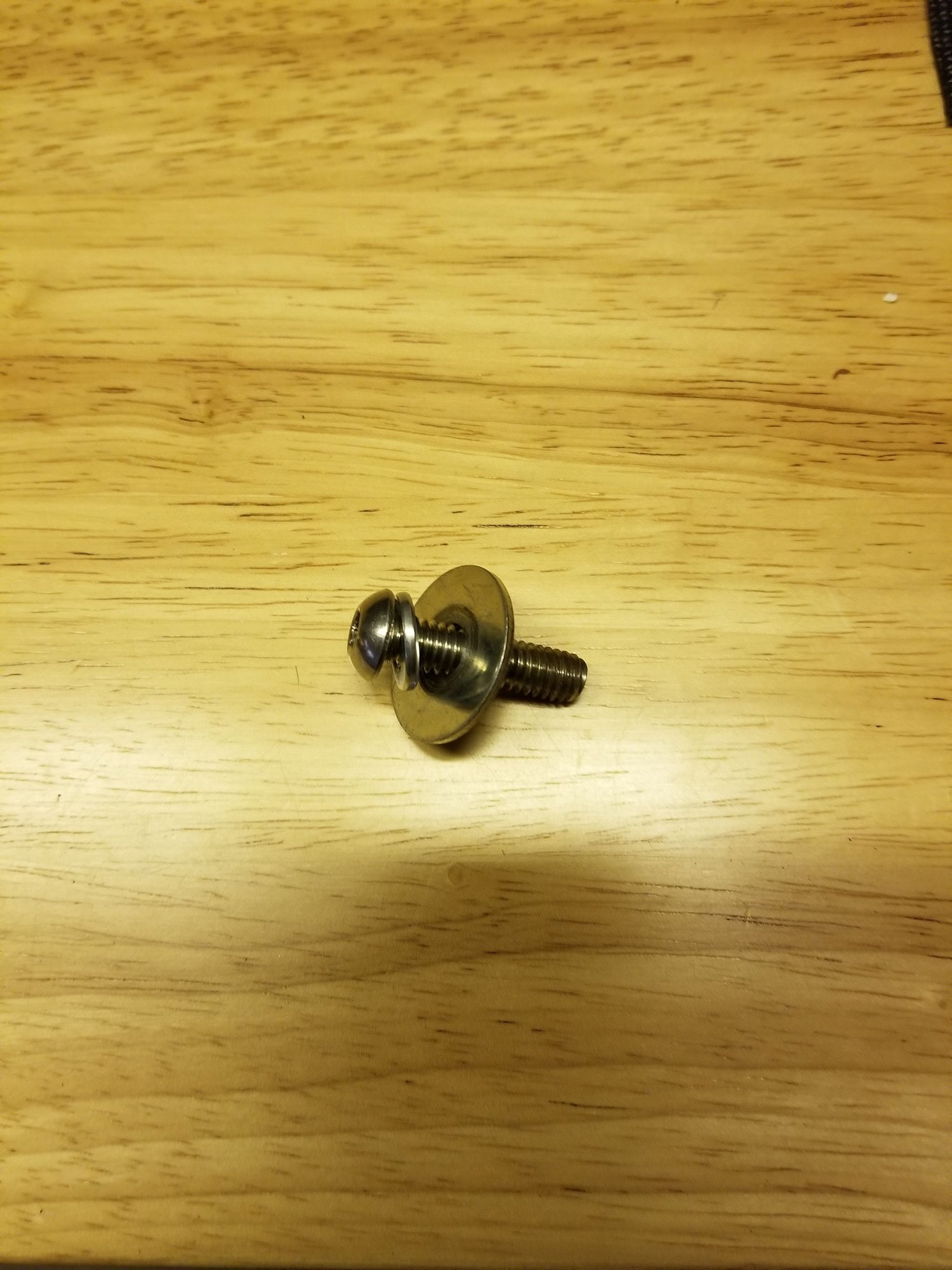

Originally Posted by hbsoldier3
Two bolts, washers and two U clips for $3 bucks. Install one in each bag.
This is exactly what i did, except i added Nylock nuts to the backside. They are a pain to install and remove ,but the bag is not coming off without an allen wrench and box end.
