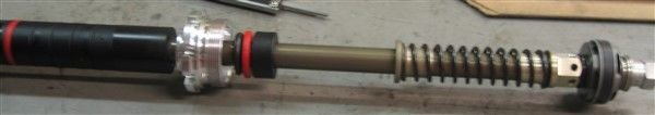

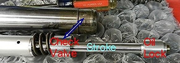

Default Things to know about building great cartridges.
To make a drop in type cartridge (like a FKC-102) one must have to contend with the check valve which is pressed into the fork tube and held on with a crimp that is pressed on. This is what holds the check valve in. The little silver cup is called an oil lock. Ohlins’s solution is to have the shock body above the check valve and that very strong OEM top out spring between the shock body on top and the top of the check valve on the bottom. The shaft is bolted on the bottom inside of the slider and inside of the oil lock for assured fitment. Top out spring explained.
For those who have no problem working with power tools either go to my site where Amy explains how to clean and mount these types of cartridges by removing the check valve. The reason why the check valve must be removed is so the cartridge body can go through the fork tube and through where the check valve use to be. This means a longer shock body.
By using a longer shock body I have the flexibility to start and stop the stroke any place I want it. Just move the spacers to where I want them. In the picture on top of the cartridge seal are spacers that can either be added to or removed as required. The single black and red spacer is the distance for full top out on the stroke. Below that is a top out spring is as long and spring tension of my choosing. If I want a real long rebound I chose a long top out spring. On these build I use 6 ž” but the bike can still sit as stock height. By using a weaker top out spring, when the front wheel falls into a hole the ride is not a noticeably change unlike the OEM front fork. Many say the front end disappears. A very cheap price (5 min.) to pay to get a superb ride using a longer shock body. These systems ride far different than any other cartridge systems out there.
This is a very short explanation.
