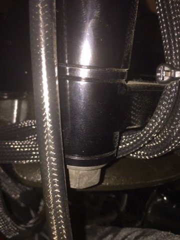

The picks below were taken off an 18' RG that had the Raptor plate with a 10" riser on. It shows how they routed the harnesses. I plane to rewire mine to follow this cleaner path, minus not having the plate to go under. Providing it for you to get an idea. I am not sure if this will require the need for wire extensions. But it shouldn't change the brake and clutch routing which worked out fine.

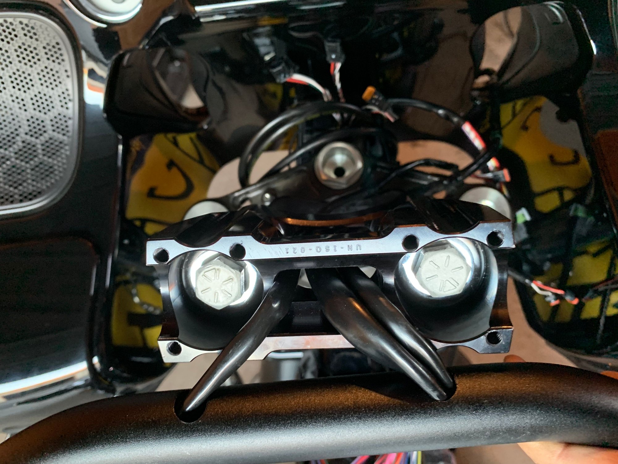

I finally got a chance to get my raptor plate and riser installed today with no problems at all, but when it came to the handlebar its become a struggle. My problem with it is that the holes for the wires to pass through on the FM/Fly handlebar doesn't line up with the riser hole in the center. So when I try to install it with the riser clamp the wires get pinched in between the bar and riser and it doesn't sit flush. I'm wondering if I bought the wrong FM/Fly handle bar from my local Harley. I'm thinking of just making a new hole or widening the holes for the wires to pass through on the bars. Did you have any trouble like this or did all your wire holes just all lined up?
If you look at the same bars on the Kraus site they run about $20 more then elseware. This is because they add a larger hole in the center of the bar. You bar does not have this hole and is the reason you are running into this issue.
