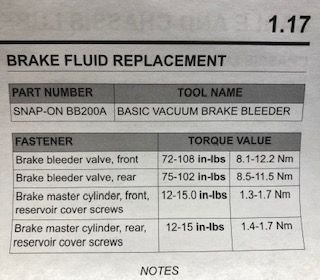

Originally Posted by '14 Limited
Looking at that schematic you’d certainly think that you’d flush the ABS Module without cycling it. I wonder what the deal is then.
I've posted the answer twice. As long as air isn't introduced into the system, the brake fluid can be "replaced" (flushed), according to the service manual, without the need to cycle the ABS module. Here's a photo of the page in the manual. I didn't post the hole procedure since the material is copyright protected.

Now you've made me wondering again. I didn't watch the reservoir as close as I should have when flushing the front brakes and did suck air in. After a few words to myself, I figured I had to visit the dealer and have him recycle the abs system. I continued with the flush, getting all the air out and hoping it would be good enough to get me to the dealer. When I finished I started the bike up and went for a test ride around the block. I didn't get any abs warning lights. The brakes worked as normal. Went through a couple of panic stops and all worked well. The link system worked as it always has. So is it because I didn't use the brakes while it had air in the system? Was I just lucky? This was about six months and 8,000 miles ago.
Dont over think it, its good. No ABS light, ABS system works. Yes, you gotta watch that reservoir, it empties fast I almost did the same thing.
Forums can take the most basic simple maintenance item and turn it into a mess of misinformation and complication based on no fact what so ever.
... and all they had to do was look at the shop manual, as others have posted here.
If it was me with what you posted, I wouldnt think or worry about it but do what you think you should, its your brakes.

Originally Posted by alarmdoug
One other misconception that I preach in this forum ALL the time is you DO NOT have to activate the ABS system to do a proper flush, just flush the brake fluid for gods sakes. We make such a big deal out of a couple minute operation! Its even in the HD shop manual! NO BIG DEAL! *L* NO ACTIVATING THE ABS SYSTEM.
Activating the ABS system is for when air is introduced into the system.
This is the truth. I even once asked my dealer about them needing to activate the abs system with their diagnostic tool for fluid change, and he said as long as no air is introduced into the system, then there is no need to have them do the fluid change.
