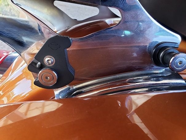

Hi all,
Hope everyone is doing okay in these crazy times. Well, I'm running out of things to do on the bike, so now I'm down to the little things that are annoying. When I bought the bike, it had the quick disconnect for the tour pak. Which is okay, I don't intend to take it off, but now the back slot where the bottom attachment is has a little play in it and when I go over a bumpy road, I can hear it. Anyone else have that problem? What was your solution? I guess I could try and put a piece of rubber around the bolt attachment to take up the slack. No, I don't want to spend a lot of money and get the non detachable support. Any ideas?

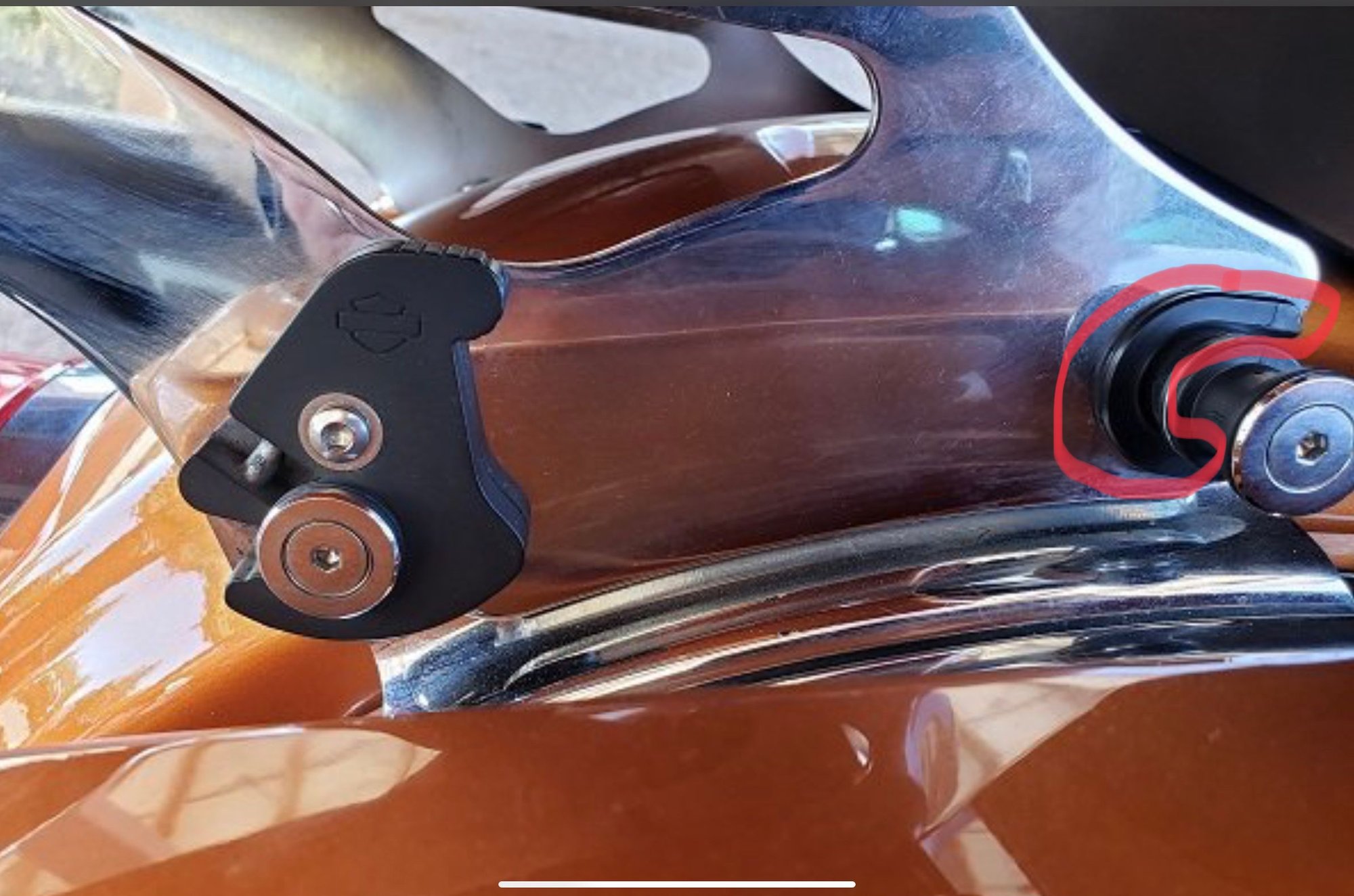

See if you have this grommet on the other side. Mine was broken. After I replaced it, the slop went away.

Yeah, the grommet is there. I think I'm just going to do the electrical tape fix. Thank you all for your suggestions.
