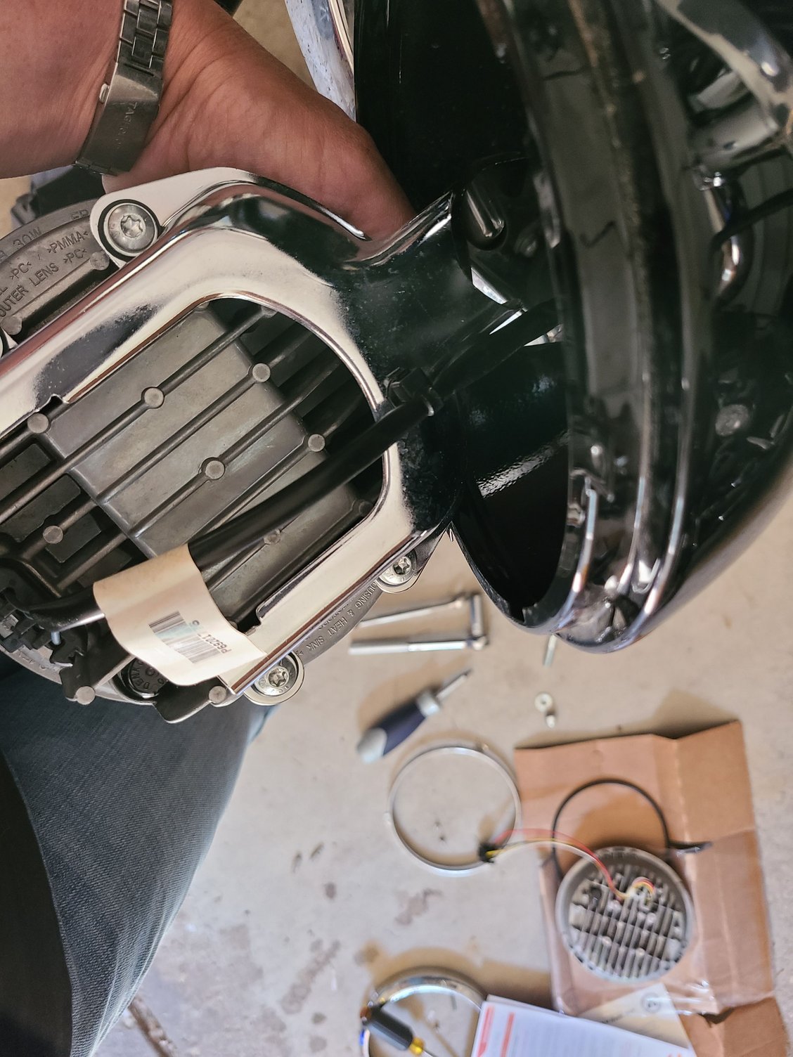

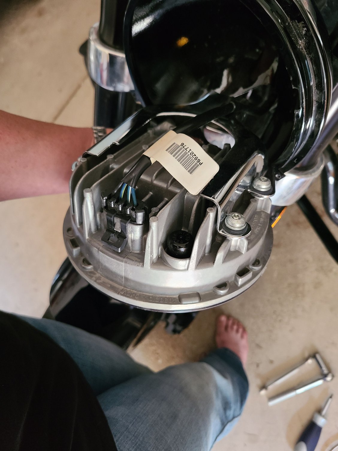

Are you installing this on a 2018+ Softtail? I bought a JW Speaker 7" 8790 Adaptive 2 headlight and took apart the OEM headlight bucket on my 2019 Sport Glide, to discover that the headlight mounting bracket connects to the back of the headlight rather than the bucket. The mounting holes on the back of the JW Speaker light are narrower than the OEM holes, but it might work with an adapter plate.
I have a 2014 Road King. It was plug and play, perfect fit. I did have to adjust it down a little with the alignment screws.
