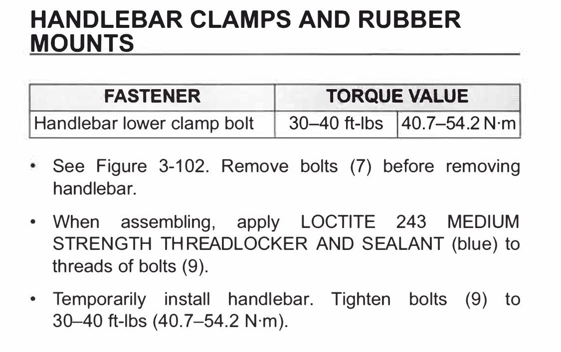

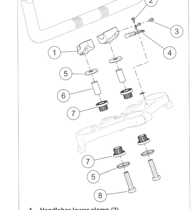

please be sure to tighten the riser bolts, they always loosen up over time
use a 1/2 drive 19mm/3/4in 6 pt socket - I do not have a torque number - properly tight
see attached
see attached
30-40 FT-LBS, with blue loctite 243
