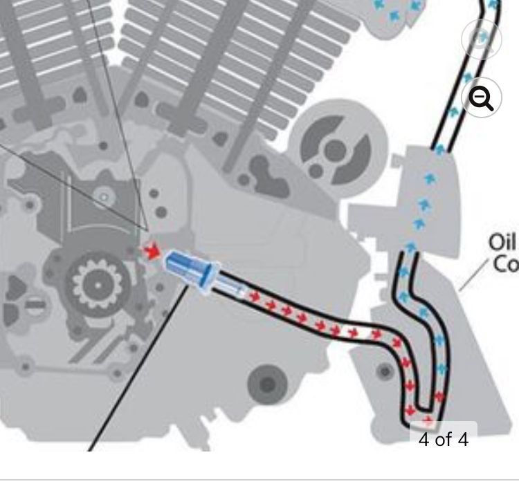

So I often get advertisements for everything HD from everywhere but this one baffled me because I never heard of such a problem in any M8 yet and this particular product advertisement makes the claim that the “Stock Oil Control Valve” (that retains the check ball) is made of formed steel that can fatigue, break and send steel fragments through the oiling system causing severe damage and I’m like wait, what?
So is this a case of S&S pimping a nonexistent problem to market an AM replacement part or is this a real thing? Anybody even heard of this chit? And wtf would it take for a simple ball check valve to actually fail?
S&S Cycle Oil Control Valve For Harley Milwaukee Eight 2017-2023

According to S&S website: "The factory oil control valve on all oil cooled M8 engines regulates the amount of oil flowing to the oil cooler/heads. The stock assembly includes a check ball retainer that is formed steel. Over time, this retainer can fatigue and break, causing chips to flow through the oil system, back into the tank and can causing significant damage along the way. The S&S oil control valve is constructed of 6061 billet aluminum and the check ball retainer is machined from high strength steel, for long-lasting durability. Don't risk the integrity of your performance engine!"
Looks like an easy bolt-on part during an oil change.
Oil Control Valve for Oil Cooled 2017-2020 HDŽ M8 Models | S&S Cycle (sscycle.com)
