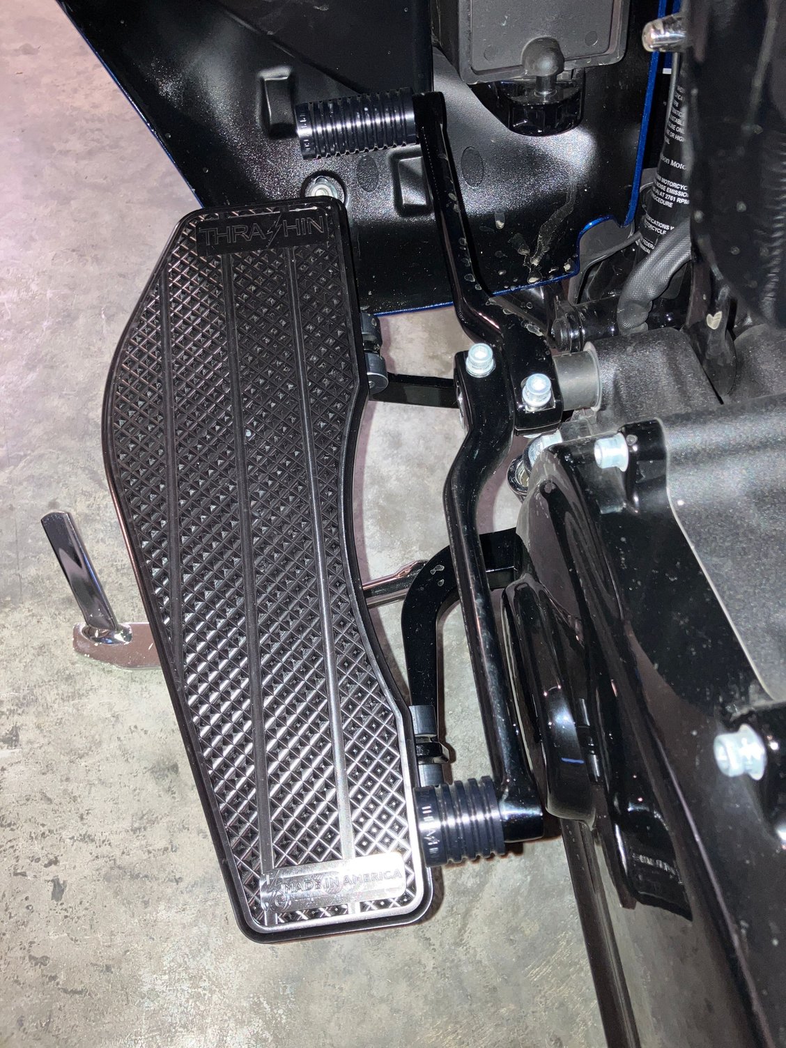

I damn near bought that Kuryaken Switch heel shifter (as much as I despise Kury) just to give it a try. It looks like a good compromise.
Then, in my search, I somehow ended up on the Thrashin' Supply website, and went with all new boards, levers, etc. so be careful!

I’m running 3/4” Kury board spacers and a Thrashin Supply shorty heel shifter tip with standard length OE levers. Adjust them as low as possible, fine tuning by adjusting the shift linkage.
I’ve run longer shift levers but this seems to provide for the least amount of foot movement to shift up or down. Size 14 boots. My heel stays on the board when downshifting and toe stays on the board upshifting.
