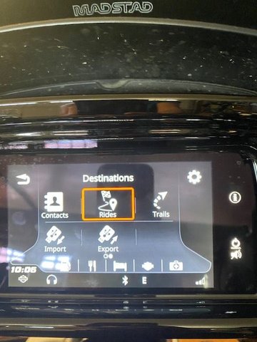

I have a 2021 Road Glide Limited.

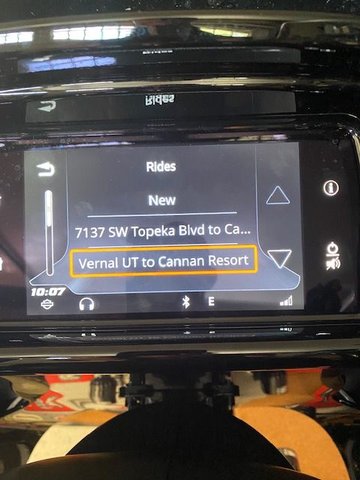

I use Basecamp to make routes. Last week I went on a three-day trip. I made two routes.

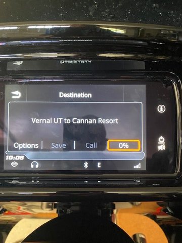

The first day was just 300 miles and maybe had 5 waypoints. The second trip was 1600 miles and had 23 waypoints. When I chose the second trip it would Fail to load, and Options was the only hot button

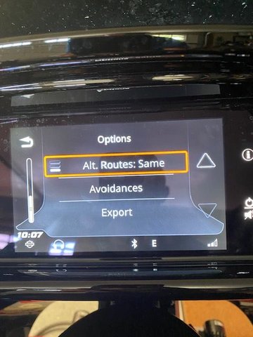

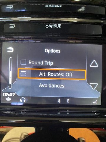

When I got home, I tried loading a few other routes and ran into the same problem. Then I found if I changed Alternate routes from Off to either Same or Different the routes would load.
Would anyone know why this is happening? In basecamp the avoidances are set for unpaved road, narrow path and climbing paths.

And on top of that I'm not sure what Alt Route same and different means..............................
