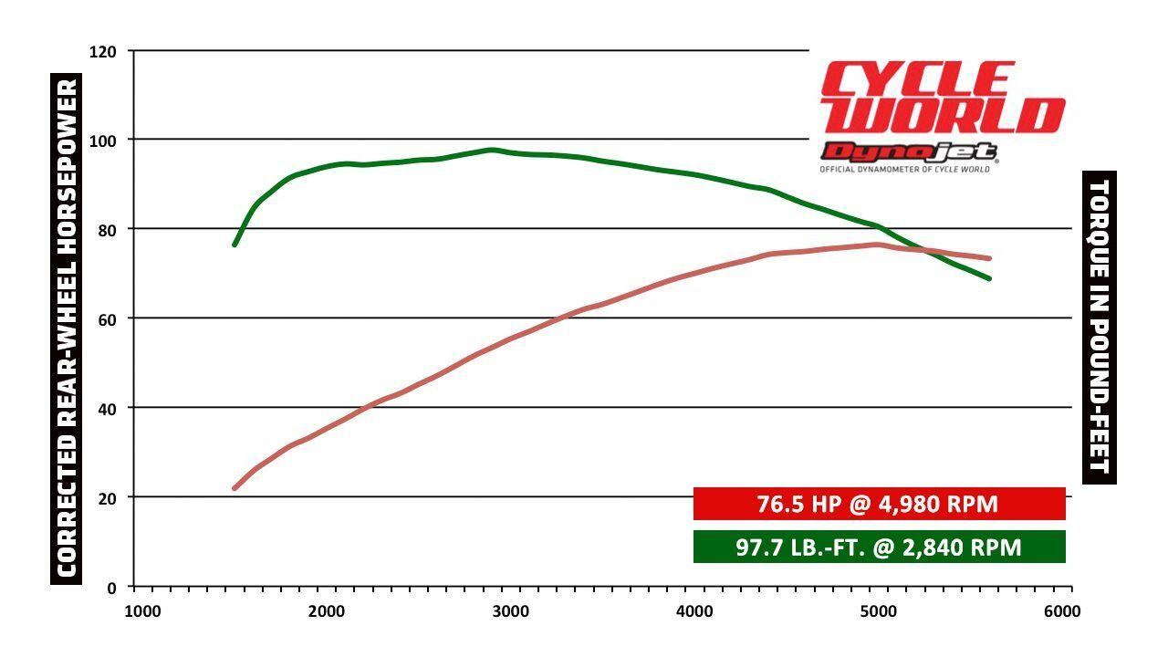

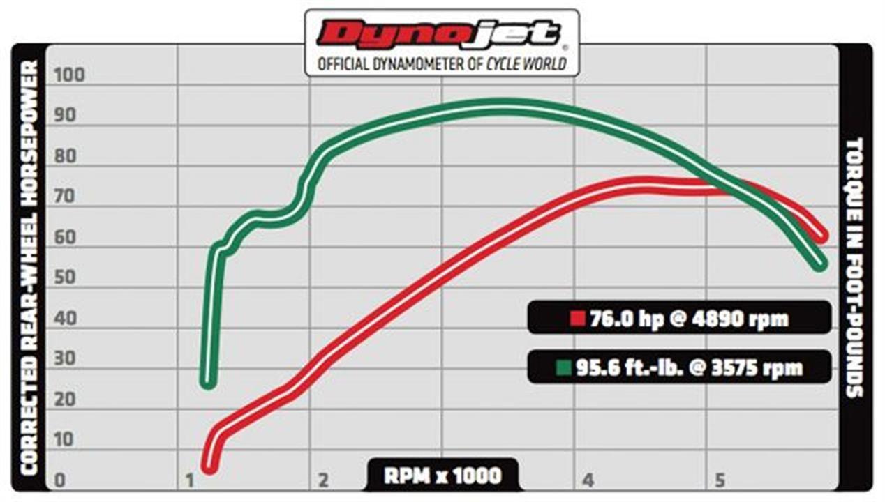

2017, 2018, and most of 2019 could have sumping issues. Oil pumps were fixed late 2019 so I would start with 2020. My buddy bought a brand new 2017 for his wife and it was rebuilt twice under warranty. Some early 107M8s had big issues and some early 107M8s had no issues. It's a mixed bag at best when talk to other 107M8 riders.
Not a dramatic difference between 2014-2016 103HO and 107M8 so don't count those out.
