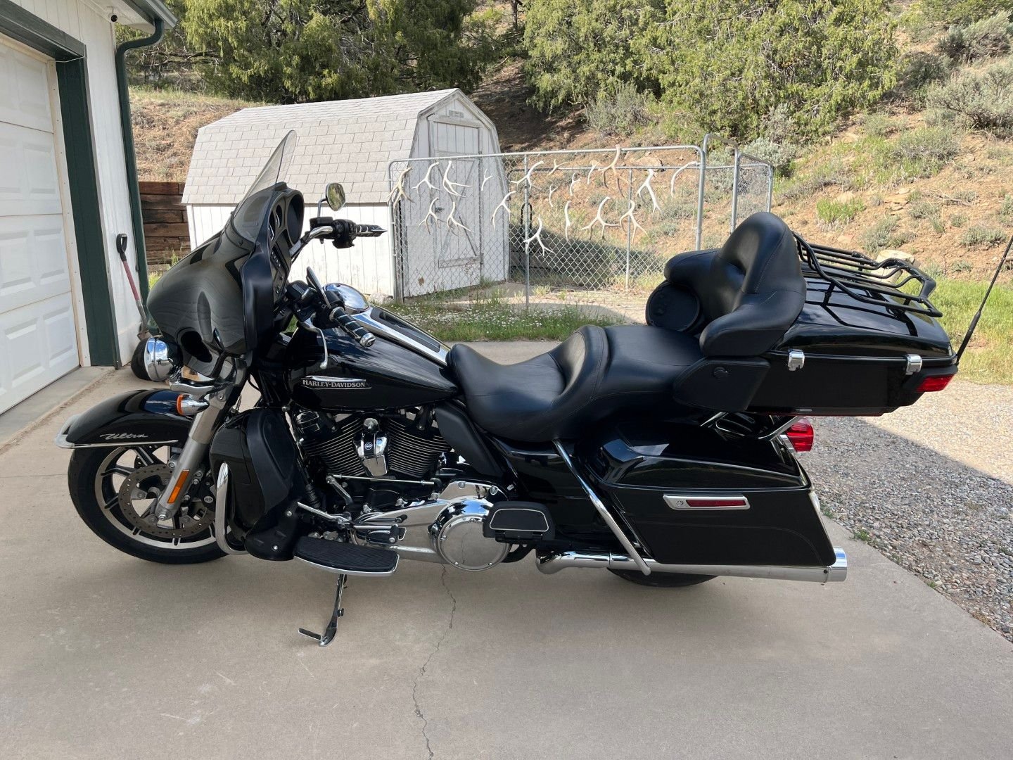

I bought a 2018 Electra Glide.
At the Durango Harley Davidson, I took it for a test ride. I decided to buy it. After signing on the dotted line we went out to the Harley. With 3 employees none of us could find the FOB. We checked each compartment and saddle bags several times. Then the salesman said this is an Ultra, it doesn't have a FOB. You have to use the key. Every time I arrive anywhere I have to get out my key and lock the fork to the side and the ignition. That was a big disappointment. Those FOBs have spoiled me. They are so convenient to just hop on an ride off.
Now my question, is there anyway to retrofit the security module and FOBs onto my Electra Glide?
