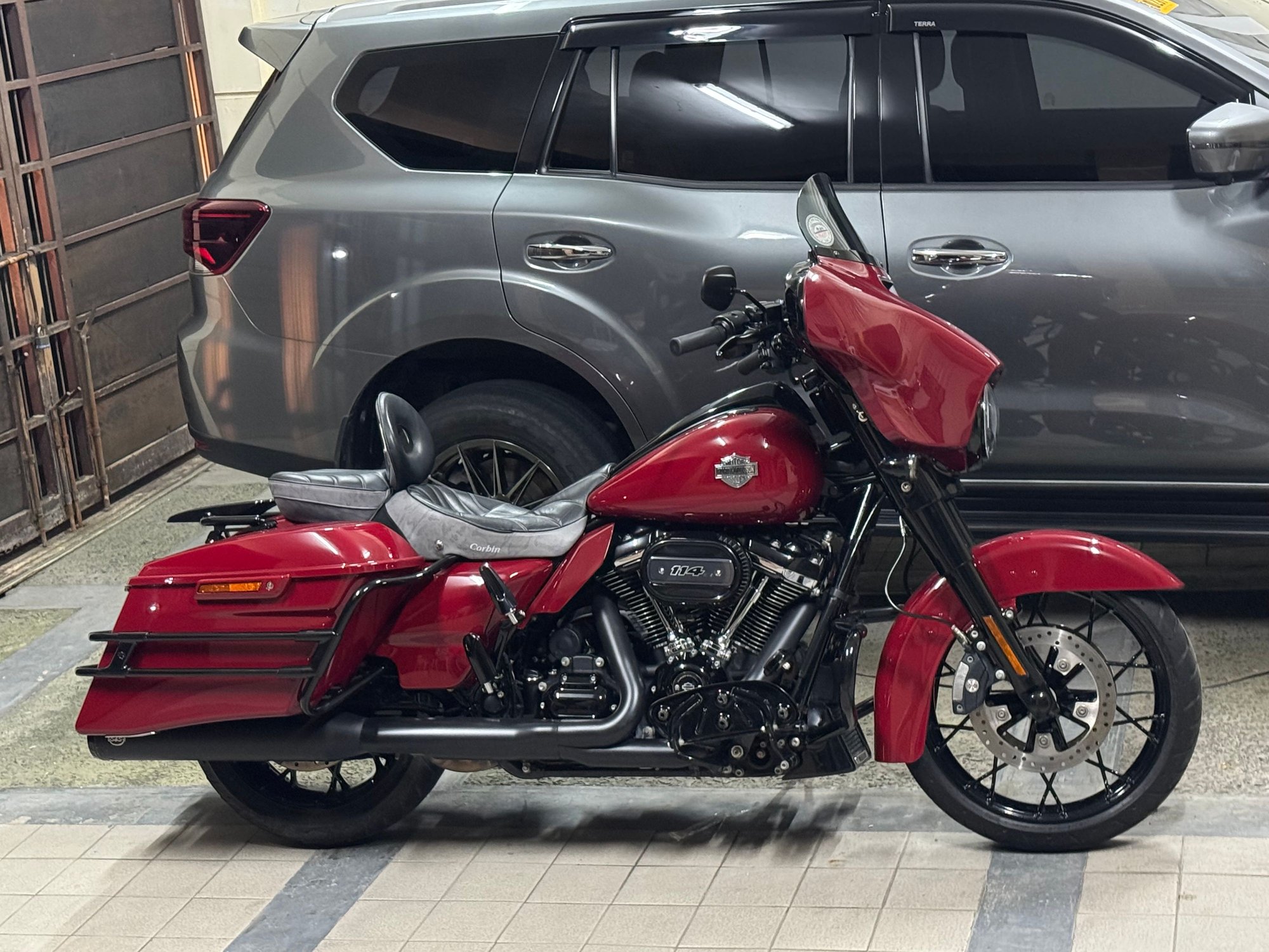

During my 2021 Street Glide service at my HD dealership two weeks ago, the technician told me he did a firmware update. It did make my bike run smoother, finding neutral became easier and gear change is now much more seamless. Was this indeed because of the software update or was it because the engine and transmission oil were replaced with new. Btw, it was for the 15K mile service.
