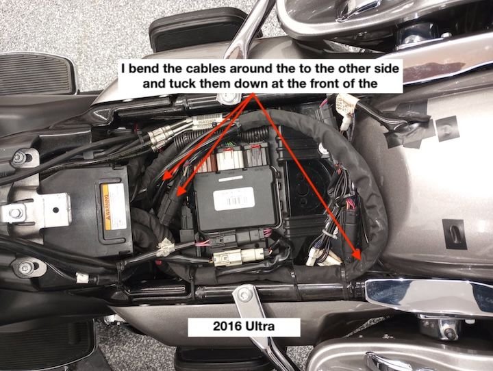

On my 2016 Ultra Classic, I use a two-up, one piece seat.
To hide the cables when I take off my tour pack..... I make one big bend of the tour pack cables toward the opposite side, then back to the front, and tuck them down forward of the battery.
I'm sure they would fit under the seat pan of a solo seat too.
Here's a pic...

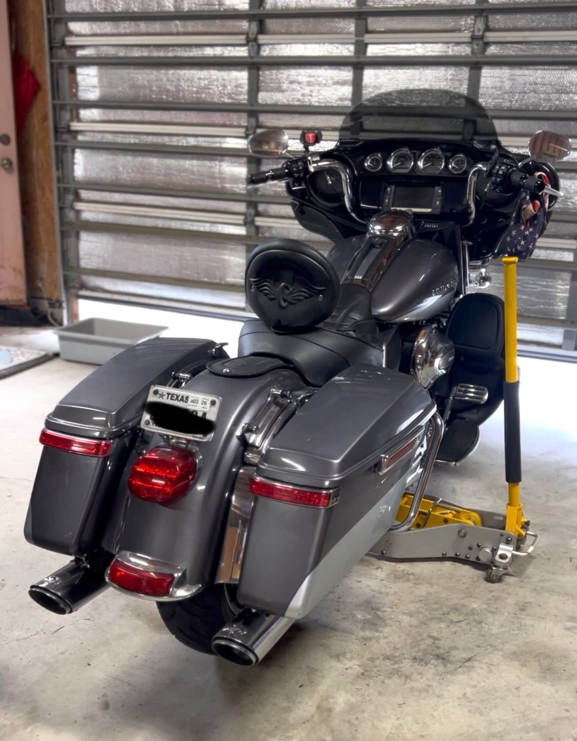

Back of my previous bike ('16 RGU), CB antenna mount using the stock antenna off the our pack, they make the same mount for the AM/FM antenna (those mounts can be installed on either side) and they have a short cable that will reach back up under the seat and plug into the antenna cable you unplugged from the tour pack. For my AM/FM I just used a hidden antenna in the fairing and it work fine for me when I used it. The hidden CB antenna didn't work for crap for me, thats why I went this route.
Then I use CD's slot lights, and their tag mount (not the one in this picture, but it is below the brake light too) and a lit tag frame wired into the brake light, then changed out the brake light lens with one from a Road King that did not have the clear "tag window".
