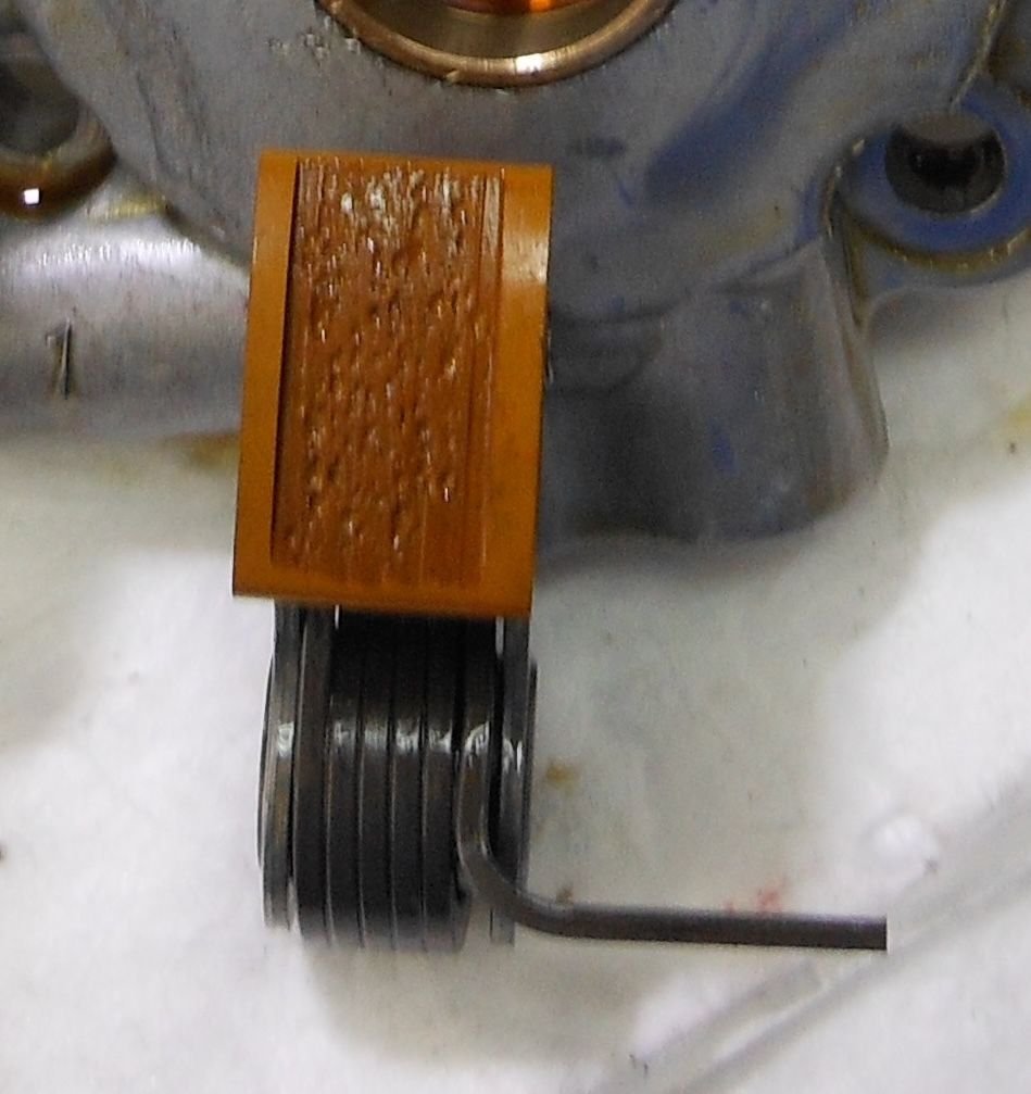

Do they wear after rollers roll? Or is there not enough tensioner material to allow that?
I have a shot of them cleanly rolling impression on the tendioners. See below.
Now Harleys tensioners on link or roller chains do get hard and brittle eventually.

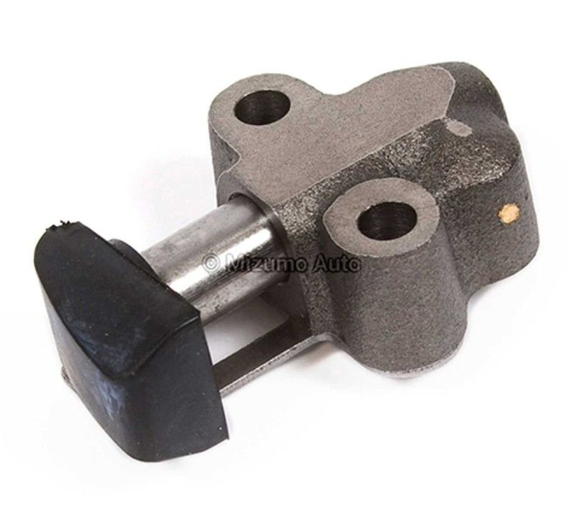

I realize it may be comparing apples to oranges but I rebuilt a 18R Toyota that had a simple hydraulic tensioner that was similar. The motor had 270K on it as I recall. There were clear signs of the rollers rolling.
Don't have a picture of Toyota one....long ago before I had a cellphone.. A new pc below that will live till the engine wears out from other issues.
I still don’t understand a damn thing you’re saying or what the hell your point is. I showed my cam chain tensioners with 64K miles on them because the OP asked about the cam chain tensioners on the Rushmore bikes. That’s all and nothing more. You, however, ramble about engines with roller chains on cam shafts cease to wear chain tensioners after the rollers start rolling. That makes no sense whatsoever. Then, you start rambling about a Toyota? Jesus Christ!

The tensioners above where OK at 64K
I was just saying they will probably last the life of a Harley motor since wear stops when the links groove in and the rollers start rolling across the tensioner.

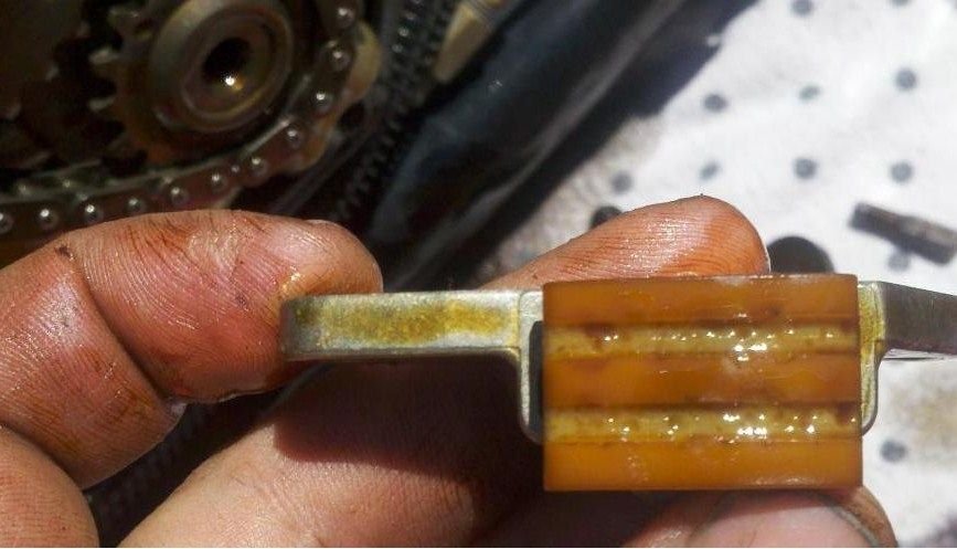

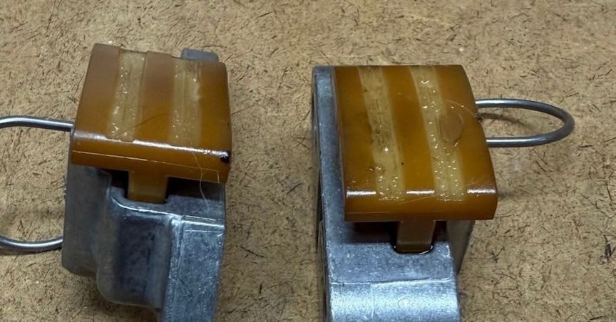

The roller chains wear into the cam tensioner pads until the rollers between the chain side plates come in contact with the pads. Then the rollers roll over the pads, and greatly reduce the amount the chain will wear away the pad.
If you look at the wear on your pads at 60K miles, then look at the wear on an early Twin Cam with half the miles, you can see how the different chain designs affect the type & extent of pad wear.
Your pads, with roller chains, at 64K miles:
Here are two pics of spring pads with link style chains. The first is a pads at about 19K miles, and 18 years old. The secnd off the internet, IIRC, had about 30K miles.
