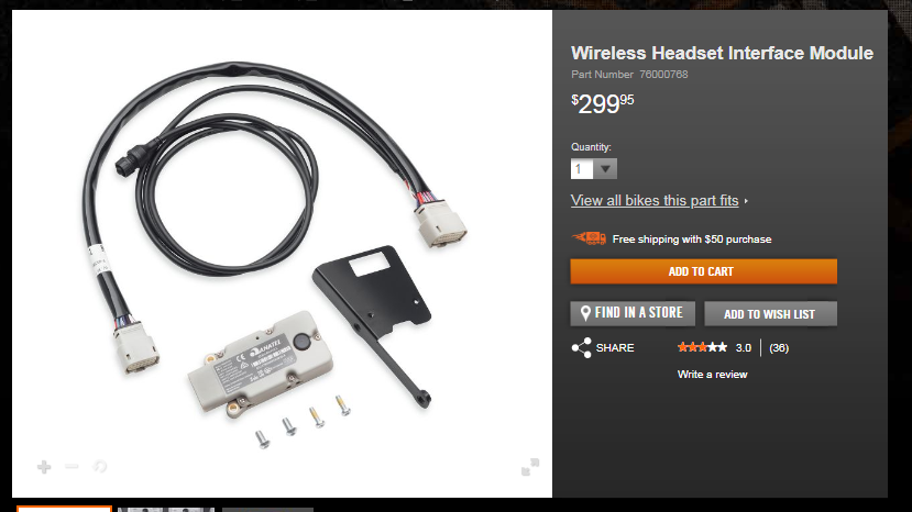

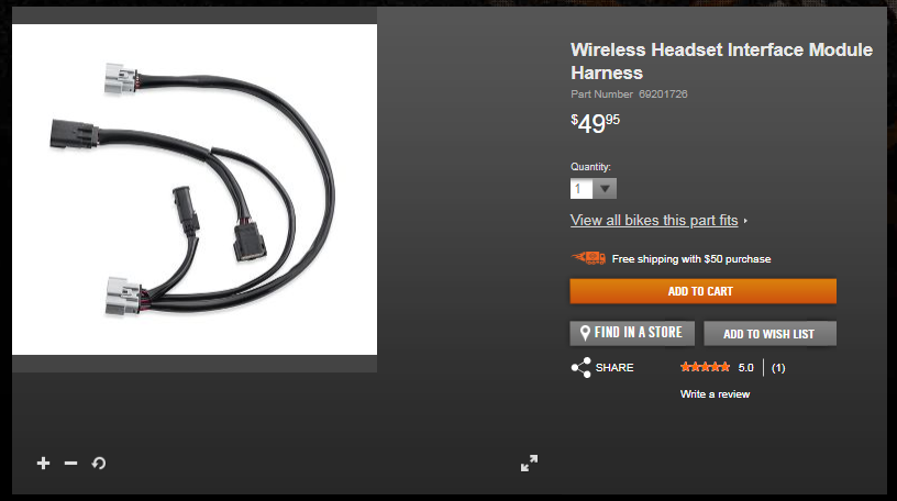

When trying to pair my Bluetooth helmet to the bike it says I may need PIN 0000 and pairing fails. The Helmet pairing instructions says to enter PIN 0000 but there is no option I can find to enter it. Anyone know to enter a Bluetooth device PIN on a 14 Ultra Classic?

You'll need to add WHIM to the bike if you want to pair BT helmet to the bike. Standard radios for 14's will only pair with BT phones, not BT helmets.

Thanks Hammz … what is WHIM?
Old Apr 30, 2019 | 10:18 AM
  #299
Hammz's Avatar
Hammz
Joined: Sep 2013
Posts: 3,820
Likes: 588
From: Michigan
WHIM is Wireless Headset Interface Module
For '14 UC you'll need these 2 items plus an update from dealer's Tech II.
