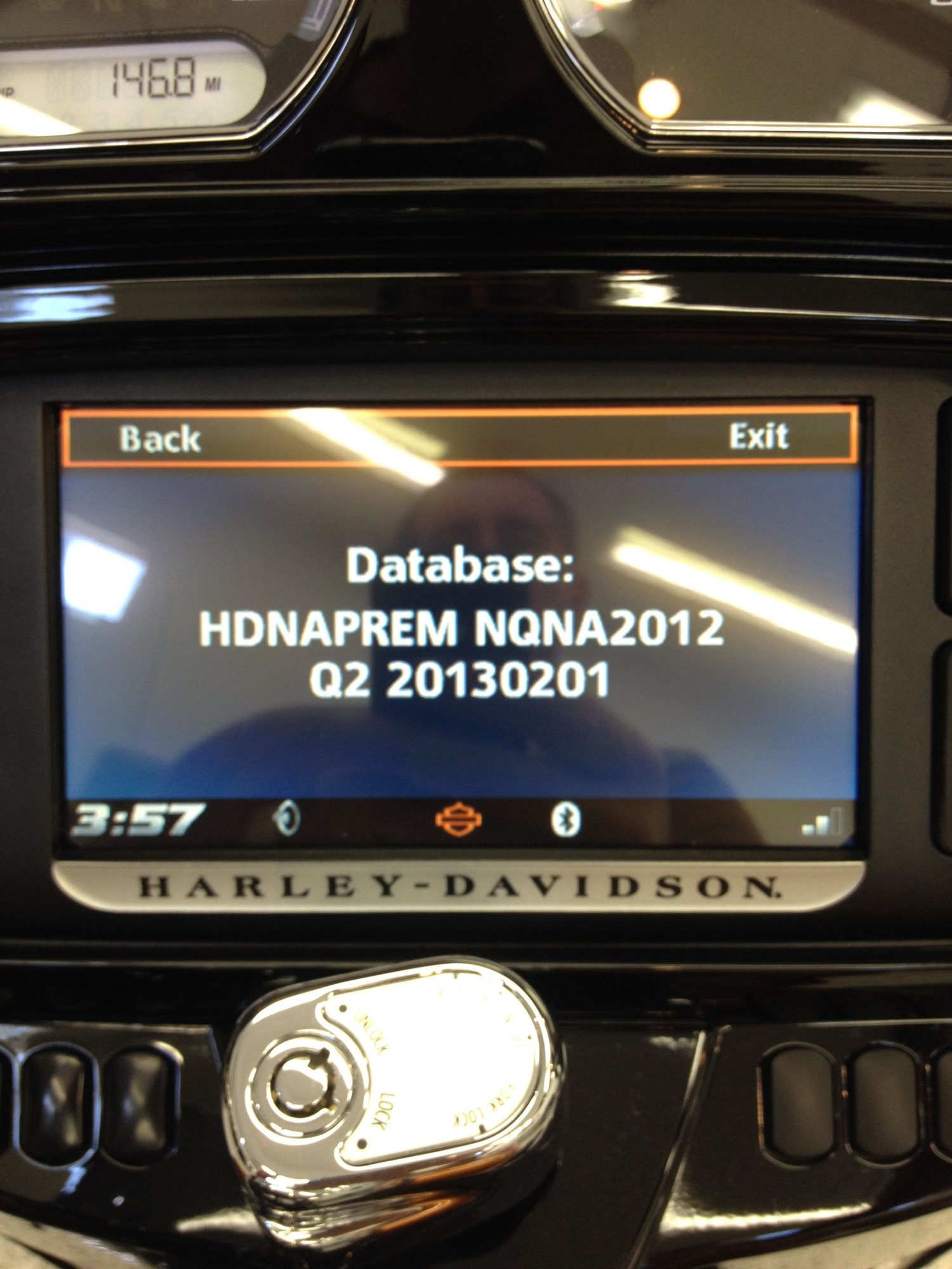

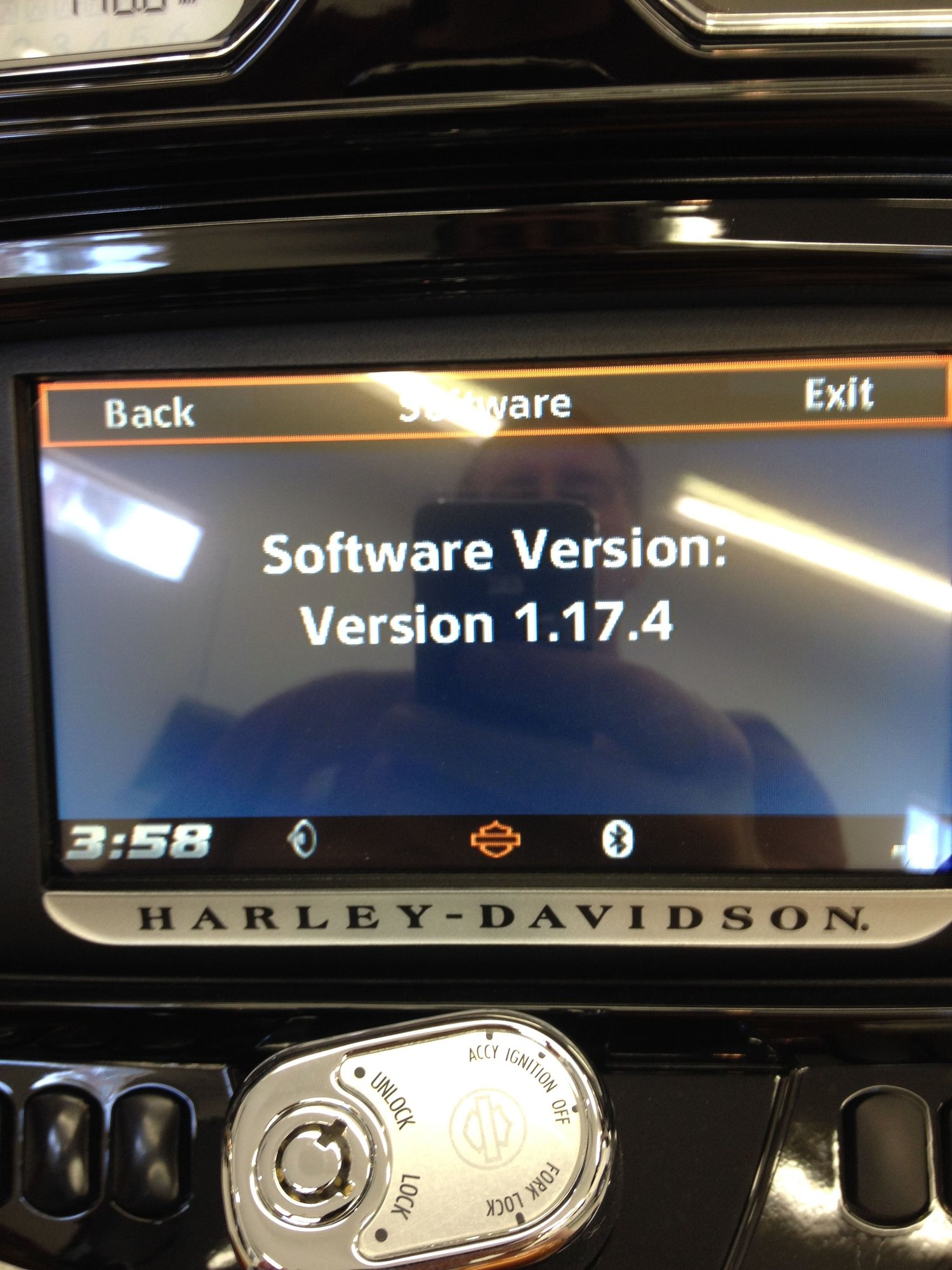

Here is my setup .4 with Q2 2013

I had the dealer upgrade to 1.17.5 yesterday, now there isn't any maps. I looked for the version and it's blank. I guess I will be back again today.

Same thing here. I had to downgrade to 1.17.4 to get them back. No matter where i downloaded it from or on what computer I downloaded it to, it wiped out my navigation. Being in IT for 20 years this baffles me. The file is fine but for whatever reason it wipes out NAV.

I was helping out another forum member who accidentally downgraded his 1.17.5 (which was factory loaded on his CVO Limited) to .4. He mistakenly thought the website had an upgrade and it actually downgraded it to .4. Now that wiped his NAV out going backwards which is odd. I'm thinking there is a nav/database conflict with both versions (weather you are downgrading .5 to .4 or upgrading from .4 to .5)
He was on the phone with them quite a few times and they said a complete new release is coming after the dealers meeting next week. They said 1.18.x will be the new one.
Smitty

Just go to the website and download .4 and reload that. It should bring them back.
