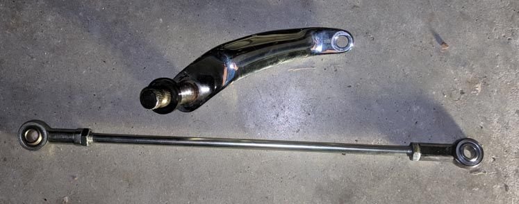

Does anyone else despise the shift linkage as much as I do? The shifter arm is chrome, the transmission arm is black and the linkage is not chrome, not black but grayish?
I just replaced my shift lever with black and my shift linkage with brass, so I have these parts left over. Maybe they would give you a more consistent look? If you want 'em, just send me a PM.

I just looked at some pics of the Heritage and it looks like you already have the same parts as I do. If you want to change to all-black, that's fairly easily done; Harley offers many black shift linkage rods and aftermarket companies offer bazillions of them. The actual shift lever is the tricky part; you'd need to order part #33900179, the black shift lever from the 2016/2017 CVO Pro Street Breakout. It'll work, but if your Heritage is like my Fat Bob (and I think they're using the same parts) then you'll have a little bit of a spacing issue, which can be resolved by picking up a 1/2" rubber grommet or an AR15 crush washer and using those instead of the spacer that comes off the shift rod.
I got the 33900179 from Surdyke for something like $35 or so. The local dealer doesn't stock it and they wanted $90 to special-order it.
